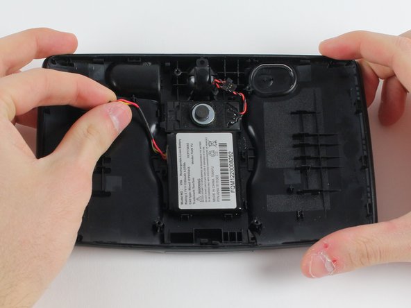

    • Disconnect the battery and speaker cables.
    • Unlatch the motherboard from the case.
  6. TomTom VIA 1530 TM Battery  Replacement, Battery: crwdns2935265:06crwdnd2935265:01crwdnd2935265:03crwdne2935265:0 TomTom VIA 1530 TM Battery  Replacement, Battery: crwdns2935265:06crwdnd2935265:02crwdnd2935265:03crwdne2935265:0 TomTom VIA 1530 TM Battery  Replacement, Battery: crwdns2935265:06crwdnd2935265:03crwdnd2935265:03crwdne2935265:0
    • Free the battery cable from its notched position.
    • Use the plastic opening tool to separate the battery from the case.
    • The tearing sound is the adhesive holding the battery tot he case. It will re-stick when you put the battery back in.
