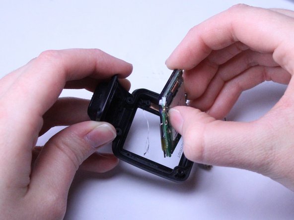

      • Gently pull the back panel away from the front panel.
      • Do not to pull too fast or too hard. There are red and black wires connected to the vibrator component that should not be ripped.

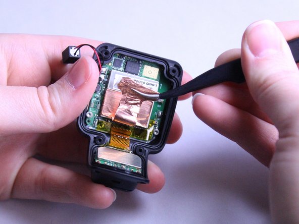

      • Now lift the smaller square of copper off the Front Panel. Use the bent, metal precision tweezers and slide it under the smaller square of copper lining then gently lift it up.
      • You will need to be gentle and pull the copper slowly so that it does not rip.
    2. TomTom Runner LCD Screen Replacement Guide: crwdns2935265:09crwdnd2935265:01crwdnd2935265:02crwdne2935265:0 TomTom Runner LCD Screen Replacement Guide: crwdns2935265:09crwdnd2935265:02crwdnd2935265:02crwdne2935265:0
      • Use the bent, metal precision tweezers to remove the thin copper piece from large square silver piece in the Front Casing.

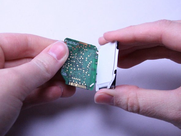

      • Using the pointed end of the black Spudger tool, gently pry the motherboard away from the screen.
      • The motherboard and screen are very fragile, but the motherboard should pop right off.
      • Once you have the motherboard partially pried off, use your fingers to gently pop it out of the clear, plastic clips holding it in place.
      • Continue to pull the motherboard away from the screen to fully expose the white backing of the screen.

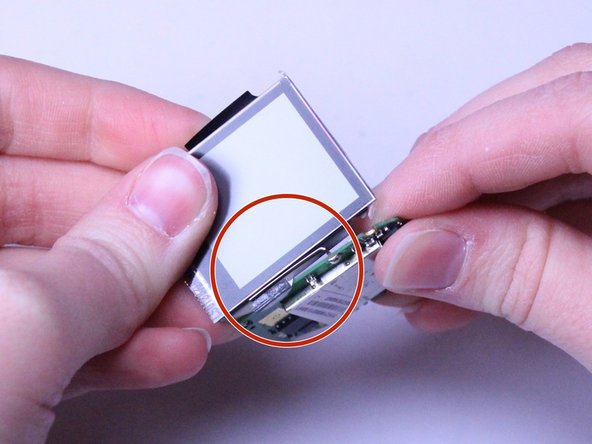

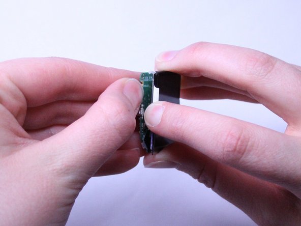

      • Once the white backing of the screen is exposed, carefully flip the two pieces, the motherboard and the screen, over while they are still connected.

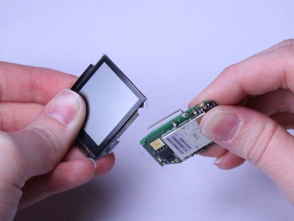

      • Look for the small metal piece attached to the motherboard that is wrapped around the front of the screen.
      • Gently slide the screen under and back to free it from the metal piece.
    4. TomTom Runner LCD Screen Replacement Guide: crwdns2935265:015crwdnd2935265:01crwdnd2935265:01crwdne2935265:0
      • Once free from the Front Casing and the motherboard, you are ready to replace the screen.
