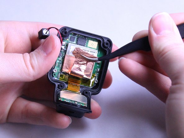

    1. TomTom Runner GPS Component Replacement, GPS Component: crwdns2935265:08crwdnd2935265:01crwdnd2935265:02crwdne2935265:0 TomTom Runner GPS Component Replacement, GPS Component: crwdns2935265:08crwdnd2935265:02crwdnd2935265:02crwdne2935265:0
      • Now lift the smaller square of copper off the front panel. Use the precision tweezers and slide it under the smaller square of copper lining then gently lift it up.
      • You will need to be gentle and pull the copper slowly so that it does not rip.

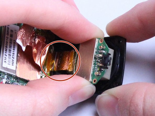

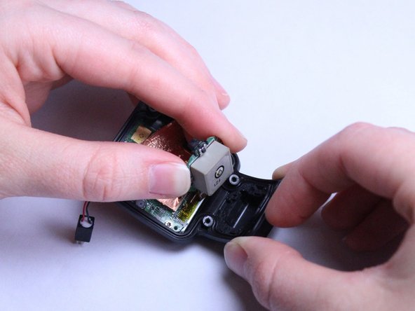

    2. TomTom Runner GPS Component Replacement: crwdns2935265:09crwdnd2935265:01crwdnd2935265:03crwdne2935265:0 TomTom Runner GPS Component Replacement: crwdns2935265:09crwdnd2935265:02crwdnd2935265:03crwdne2935265:0 TomTom Runner GPS Component Replacement: crwdns2935265:09crwdnd2935265:03crwdnd2935265:03crwdne2935265:0
      • Use your fingers to gently grab and lift the small square piece to remove the GPS and button component competely from the casing.
      • Disconnect the ZIF Connector from the larger green motherboard.
      • The ZIF Connector is the flat, orange cable connecting the small green motherboard to the larger motherboard. It is meant to come apart at the port located on the larger motherboard. You will feel like you have broken it when it is disconnected. That is okay!

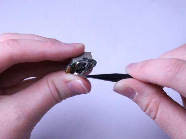

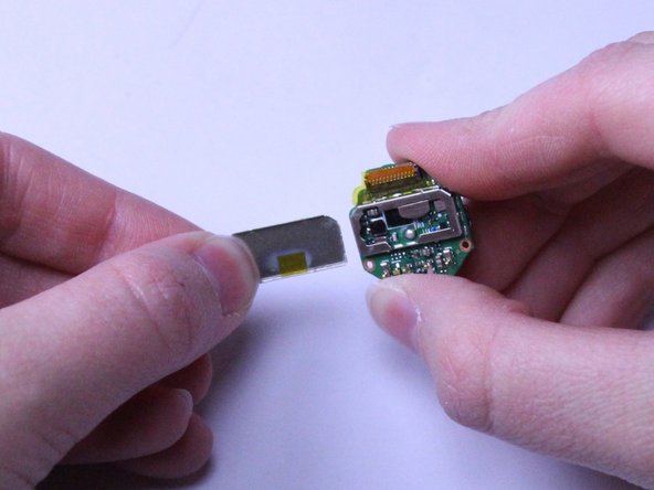

    3. TomTom Runner GPS Component Replacement: crwdns2935265:010crwdnd2935265:01crwdnd2935265:03crwdne2935265:0 TomTom Runner GPS Component Replacement: crwdns2935265:010crwdnd2935265:02crwdnd2935265:03crwdne2935265:0 TomTom Runner GPS Component Replacement: crwdns2935265:010crwdnd2935265:03crwdnd2935265:03crwdne2935265:0
      • Get the GPS/Button Component by itself and use the Spudger tool to lift the silver cover off the GPS Component. This will expose the GPS Component.

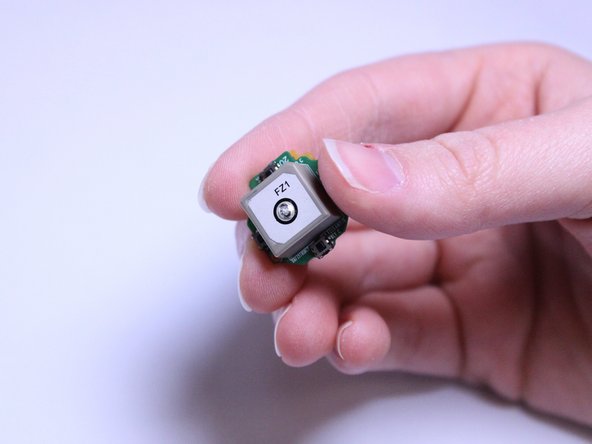

      • Once the GPS Component cover is off and the GPS Component is exposed, you are ready to replace it.
      • The GPS Component is the entire square, grey box piece with the green motherboard attached to it.
