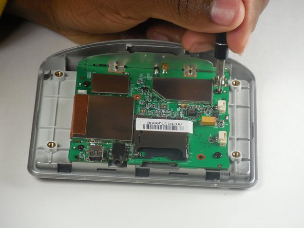

  5. TomTom One XL Screen Replacement, Screen: crwdns2935265:05crwdnd2935265:01crwdnd2935265:02crwdne2935265:0 TomTom One XL Screen Replacement, Screen: crwdns2935265:05crwdnd2935265:02crwdnd2935265:02crwdne2935265:0
    • Locate the 4 .4mm screws connecting the circuit board to the front panel.
    • Use the T6 Torx screwdriver and remove the four screws.

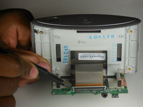

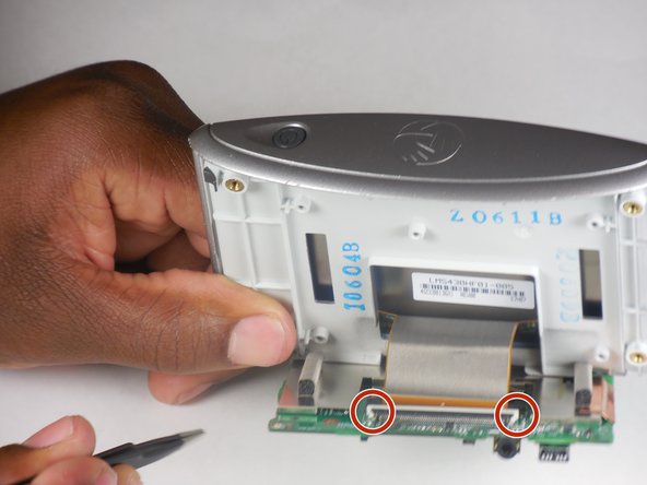

  6. TomTom One XL Screen Replacement: crwdns2935265:06crwdnd2935265:01crwdnd2935265:03crwdne2935265:0 TomTom One XL Screen Replacement: crwdns2935265:06crwdnd2935265:02crwdnd2935265:03crwdne2935265:0 TomTom One XL Screen Replacement: crwdns2935265:06crwdnd2935265:03crwdnd2935265:03crwdne2935265:0
    • Locate the ribbon cable connecting the front panel to the circuit board.
    • Locate the white tab locking the ribbon in place.
    • Using precision tweezers push the left and right side of the tab forward.
    • Gently pull the ribbon to disconnect the circuit board from the front panel.
    • If gently pulling on the ribbon doesn't release it then the tab hasn't been pushed far enough forward.

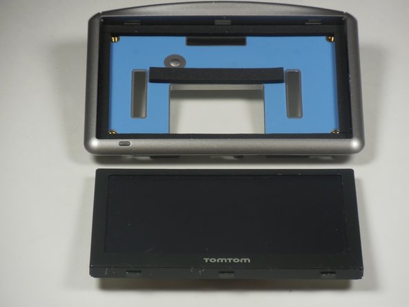

  7. TomTom One XL Screen Replacement: crwdns2935265:07crwdnd2935265:01crwdnd2935265:03crwdne2935265:0 TomTom One XL Screen Replacement: crwdns2935265:07crwdnd2935265:02crwdnd2935265:03crwdne2935265:0 TomTom One XL Screen Replacement: crwdns2935265:07crwdnd2935265:03crwdnd2935265:03crwdne2935265:0
    • Use the palate knife to pry the screen away from the front panel.
    • Pry between the light gray board and the black boarder of the TOMTOM XL screen.
    • Use moderate pressure when prying, slide the palate knife back and forth, and eventually the screen should pop out.
