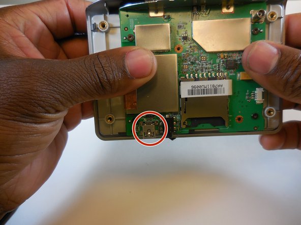

  5. TomTom One XL Charging Port Replacement, Charging Port: crwdns2935265:05crwdnd2935265:01crwdnd2935265:02crwdne2935265:0 TomTom One XL Charging Port Replacement, Charging Port: crwdns2935265:05crwdnd2935265:02crwdnd2935265:02crwdne2935265:0

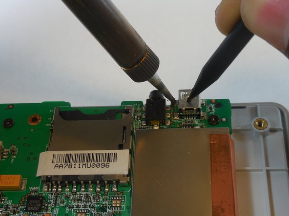

    • If this is your first time solder then refer to IFixIt's safety guide.
    • Locate where the charger port goes on the circuit board.
    • Locate the four connecter on circuit board and charger port which need to be soldered.
    • Don't forget, the soldering iron is hot.

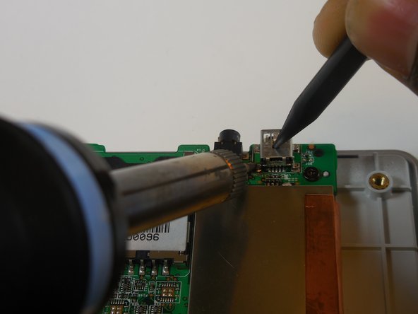

  6. TomTom One XL Charging Port Replacement: crwdns2935265:06crwdnd2935265:01crwdnd2935265:03crwdne2935265:0 TomTom One XL Charging Port Replacement: crwdns2935265:06crwdnd2935265:02crwdnd2935265:03crwdne2935265:0 TomTom One XL Charging Port Replacement: crwdns2935265:06crwdnd2935265:03crwdnd2935265:03crwdne2935265:0
    • Using your plastic opening tool press down firmly on the top of the charger port.
    • While the soldering iron is hot press it again the four corners of the charger port.
    • Don't touch the charger port with your hands, it may have heated up during soldering.
