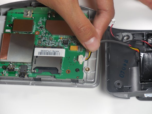

  4. TomTom One XL Battery Replacement: crwdns2935265:04crwdnd2935265:01crwdnd2935265:02crwdne2935265:0 TomTom One XL Battery Replacement: crwdns2935265:04crwdnd2935265:02crwdnd2935265:02crwdne2935265:0
    • Using the tweezers separate the wires connecting the battery and speaker to the mother board.
    • Be gentle while pulling the wires out, the plugs are easily injured.
