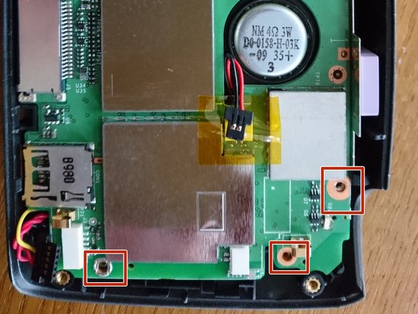

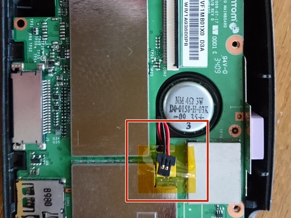

    • Next, the main board should be disconnected from the battery
    • and from the loud speaker
  4. TomTom Go Blue and Me Disassembly, Battery and loudspeaker: crwdns2935265:04crwdnd2935265:01crwdnd2935265:02crwdne2935265:0 TomTom Go Blue and Me Disassembly, Battery and loudspeaker: crwdns2935265:04crwdnd2935265:02crwdnd2935265:02crwdne2935265:0
    • You can now unscrew the mainboard
  5. TomTom Go Blue and Me Disassembly, access to battery and loudspeaker: crwdns2935265:05crwdnd2935265:01crwdnd2935265:01crwdne2935265:0
    • When you now lift out the mainboard, you have access to the battery and loudspeaker.

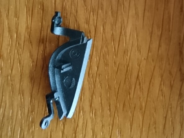

  6. TomTom Go Blue and Me Disassembly, On/Off button: crwdns2935265:06crwdnd2935265:01crwdnd2935265:02crwdne2935265:0 TomTom Go Blue and Me Disassembly, On/Off button: crwdns2935265:06crwdnd2935265:02crwdnd2935265:02crwdne2935265:0
    • This little piece of plastic was my reason for opening it up. The longer leg was broken. I glued it with superglue and put it back. so far this seams feasible
    • Please note the broken bits in the holes at the end of the legs: you can not actually take this out without breaking it! so be ware!
