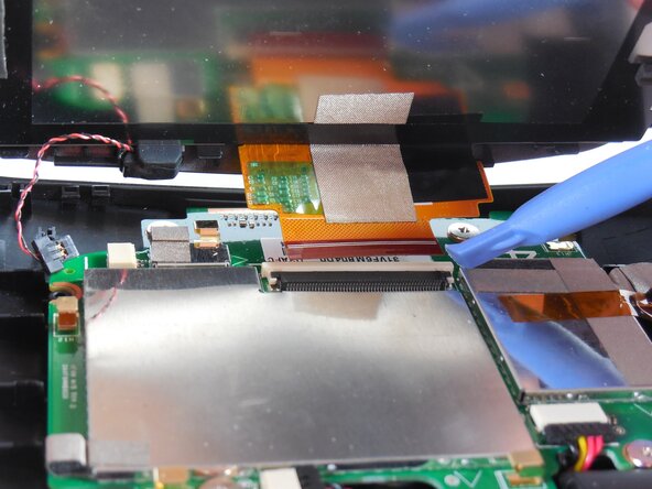

  2. TomTom GO Live 1535M Screen Replacement, Cables: crwdns2935265:02crwdnd2935265:01crwdnd2935265:02crwdne2935265:0 TomTom GO Live 1535M Screen Replacement, Cables: crwdns2935265:02crwdnd2935265:02crwdnd2935265:02crwdne2935265:0
    • Use the wide end of a spudger to push on the sliding connector tab to slide it out of its socket and disconnect the reset button cable.
    • It may take a lot of force to disconnect the cable. Go slowly, and don't pull on the cables.
    • To reconnect the cable, align the connector and use a spudger to push against the tab to fully seat the connector back into the socket.
    • Use the wide end of a spudger or a clean fingernail to flip up the locking flap on the ZIF connector—the unlocked position.
    • Once the flap is in the unlocked position, use tweezers or your fingers to gently pull the cable out of its socket.
    • To reconnect, make sure the locking flap is flipped up and gently reinsert the cable. Then, flip the locking flap down to secure the cable. The cable should slide into the socket with little to no force. If you're having trouble, remove it, check that the flap is fully unlocked, and try again.

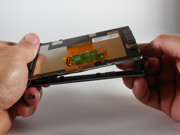

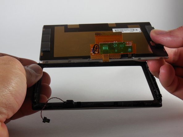

  3. TomTom GO Live 1535M Screen Replacement, Removing the Screen: crwdns2935265:03crwdnd2935265:01crwdnd2935265:03crwdne2935265:0 TomTom GO Live 1535M Screen Replacement, Removing the Screen: crwdns2935265:03crwdnd2935265:02crwdnd2935265:03crwdne2935265:0 TomTom GO Live 1535M Screen Replacement, Removing the Screen: crwdns2935265:03crwdnd2935265:03crwdnd2935265:03crwdne2935265:0
    • Push the screen up-and-out of the outside rim to remove it.
    • As you remove the screen, you may hear a 'tearing' sound. Do not panic, as this is just the leftover substance that holds the screen in place. It will re-stick when the screen in placed back.

I just replaced the screen. But with the cable ribbon installed the screen does not activate. The startup tom-tom sound does play. The screen is blank. But the old screen does not work as well. Prior to this the screen did work but was un responsive. Any thoughts?
