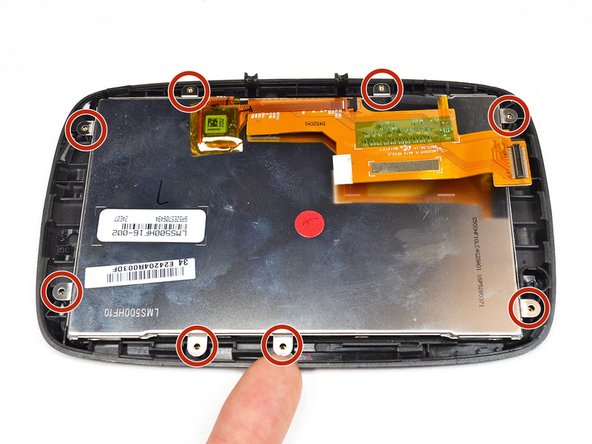

  9. TomTom GO 500 Display or Digitizer Replacement: crwdns2935265:09crwdnd2935265:01crwdnd2935265:02crwdne2935265:0 TomTom GO 500 Display or Digitizer Replacement: crwdns2935265:09crwdnd2935265:02crwdnd2935265:02crwdne2935265:0
    • Unscrew the eight 2.5mm screws along the perimeter of the display using the Phillips #000 screwdriver.
  10. TomTom GO 500 Display or Digitizer Replacement: crwdns2935265:010crwdnd2935265:01crwdnd2935265:03crwdne2935265:0 TomTom GO 500 Display or Digitizer Replacement: crwdns2935265:010crwdnd2935265:02crwdnd2935265:03crwdne2935265:0 TomTom GO 500 Display or Digitizer Replacement: crwdns2935265:010crwdnd2935265:03crwdnd2935265:03crwdne2935265:0
    • Separate the display from the digitizer. The display is now fully removed from the device.
