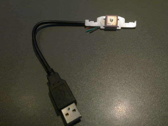

  3. TomTom - GPS Replacement, Externalize the GPS element: crwdns2935265:03crwdnd2935265:01crwdnd2935265:03crwdne2935265:0 TomTom - GPS Replacement, Externalize the GPS element: crwdns2935265:03crwdnd2935265:02crwdnd2935265:03crwdne2935265:0 TomTom - GPS Replacement, Externalize the GPS element: crwdns2935265:03crwdnd2935265:03crwdnd2935265:03crwdne2935265:0
    • In this step connect the GPS element by a cable to the motherboard.
    • You can use any cable with two threads. I used a USB extension cable so I can easily (un)plug the GPS element to the TomTom. I cut the cable in half and soldered two ( I used the white and red) threads to the two connectors of the GPS element in the middle on the back.
    • I soldered the same colored threads of the other half of the USB cable to the connectors on the motherboard. Be sure to solder the GPS-element in the right way to the threats, as it was originally soldered onto the motherboard. It might not work the other way around.
  4. TomTom - GPS Replacement, The final result: crwdns2935265:04crwdnd2935265:01crwdnd2935265:01crwdne2935265:0
    • Make a hole on the side of your TomTom. Find the place where you can lead the cable out without damaging other electrical elements and without making the connection fragile.
    • This is the way it looks at the moment. It works. Insert another USB extension cable and you can put the GPS element wherever the reception is best.
    • Of course a little box to put the GPS antenna in makes it all the more aesthetic and robust. I simply glued the cable to the metal of the GPS element and will probably stick it to the window with a two sided tape.
    • I guess the antenna works best with the purple element directed to the sky.
