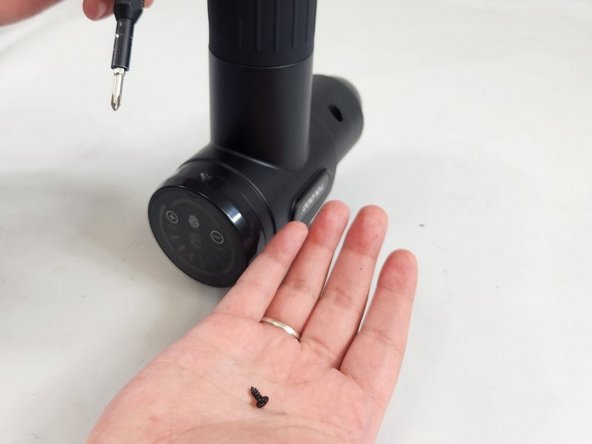

    • Remove rubber pieces at the bottom of the massage gun’s barrel with the spudger by inserting it between the rubber and the plastic and use the tip of the spudger to pry the rubber out.
  2. Toloco EM26 Small Washers Replacement: crwdns2935265:02crwdnd2935265:01crwdnd2935265:01crwdne2935265:0
    • Remove the two 13.48 mm screws on the bottom of the massage gun with a Phillips #00 screwdriver.
  3. Toloco EM26 Small Washers Replacement: crwdns2935265:03crwdnd2935265:01crwdnd2935265:02crwdne2935265:0 Toloco EM26 Small Washers Replacement: crwdns2935265:03crwdnd2935265:02crwdnd2935265:02crwdne2935265:0
    • Remove the 8.11 mm small black screw on the edge of circular plate with a Phillips #00 Screwdriver.
  4. Toloco EM26 Small Washers Replacement: crwdns2935265:04crwdnd2935265:01crwdnd2935265:01crwdne2935265:0
    • Take off the cap of the massage gun by simply lifting it off the device.
    • Be careful to secure the cap as the back part of the gun may fall.
  5. Toloco EM26 Small Washers Replacement: crwdns2935265:05crwdnd2935265:01crwdnd2935265:02crwdne2935265:0 Toloco EM26 Small Washers Replacement: crwdns2935265:05crwdnd2935265:02crwdnd2935265:02crwdne2935265:0
    • Remove the 19.9 mm silver screw with the hex bit attachment.
  6. Toloco EM26 Small Washers Replacement: crwdns2935265:06crwdnd2935265:01crwdnd2935265:01crwdne2935265:0
    • Remove 1 thin silver metallic washer, and 1 thick black metallic washer.
