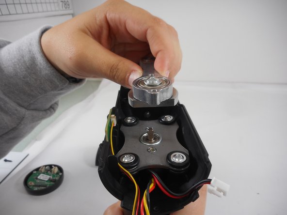

    • Remove the 14.85 mm black screw from the underside of the rotary arm with allen wrench attachment.
  7. Toloco EM26 Motor Replacement: crwdns2935265:07crwdnd2935265:01crwdnd2935265:02crwdne2935265:0 Toloco EM26 Motor Replacement: crwdns2935265:07crwdnd2935265:02crwdnd2935265:02crwdne2935265:0
    • Grasp the rotary arm and carefully pull up to remove it from the device.

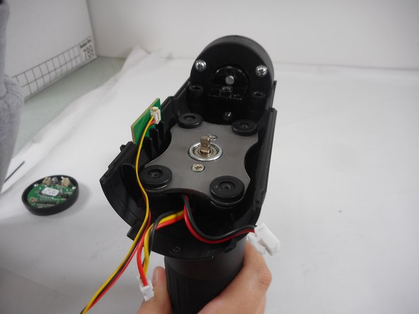

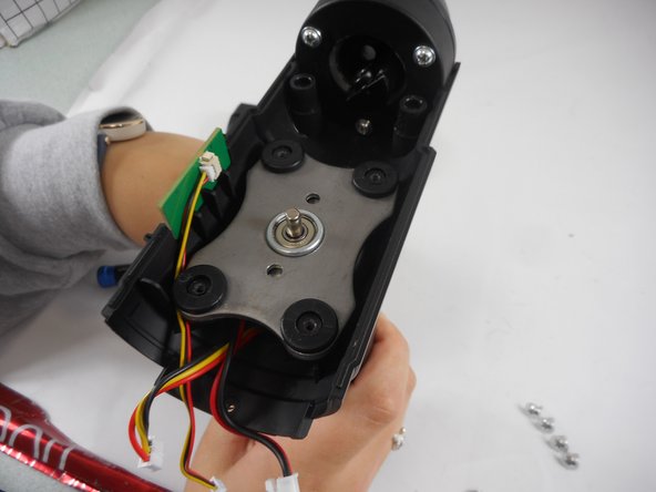

    • Remove the four 11.26 mm silver screws from each side of the motor frame with a Phillips #00 screwdriver.
  9. Toloco EM26 Motor Replacement: crwdns2935265:09crwdnd2935265:01crwdnd2935265:03crwdne2935265:0 Toloco EM26 Motor Replacement: crwdns2935265:09crwdnd2935265:02crwdnd2935265:03crwdne2935265:0 Toloco EM26 Motor Replacement: crwdns2935265:09crwdnd2935265:03crwdnd2935265:03crwdne2935265:0

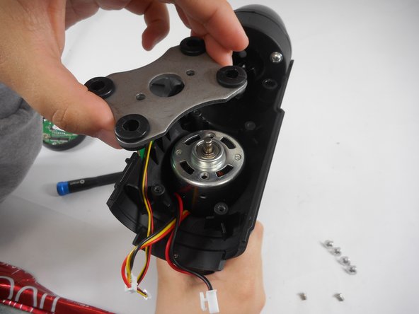

    • Remove the two 6.14 mm silver screws located on the top plate with a Phillips #00 screwdriver.
    • Grasp the plate and carefully pull up to remove the plate from the device.

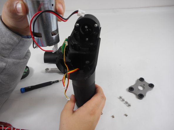

  10. Toloco EM26 Motor Replacement: crwdns2935265:010crwdnd2935265:01crwdnd2935265:02crwdne2935265:0 Toloco EM26 Motor Replacement: crwdns2935265:010crwdnd2935265:02crwdnd2935265:02crwdne2935265:0
    • Remove the top of the motor and carefully pull it out of the device.
    • Be sure that the wiring is disconnected from the large motherboard.
