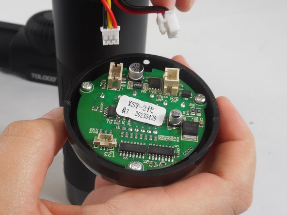

Toloco EM26 Large Motherboard Replacement
  1. Toloco EM26 Large Motherboard Replacement, Large Motherboard: crwdns2935265:01crwdnd2935265:01crwdnd2935265:02crwdne2935265:0 Toloco EM26 Large Motherboard Replacement, Large Motherboard: crwdns2935265:01crwdnd2935265:02crwdnd2935265:02crwdne2935265:0
    • Remove rubber pieces at the bottom of the massage gun’s barrel with the spudger by inserting it between the rubber and the plastic, and use the tip of the spudger to pry the rubber out.
  2. Toloco EM26 Large Motherboard Replacement: crwdns2935265:02crwdnd2935265:01crwdnd2935265:01crwdne2935265:0
    • Remove the two 13.48 mm screws on the bottom of the massage gun with a Phillips #00 screwdriver.
  3. Toloco EM26 Large Motherboard Replacement: crwdns2935265:03crwdnd2935265:01crwdnd2935265:02crwdne2935265:0 Toloco EM26 Large Motherboard Replacement: crwdns2935265:03crwdnd2935265:02crwdnd2935265:02crwdne2935265:0
    • Remove the 8.11 mm small black screw on the edge of circular plate with a Phillips #00 Screwdriver.
  4. Toloco EM26 Large Motherboard Replacement: crwdns2935265:04crwdnd2935265:01crwdnd2935265:01crwdne2935265:0
    • Take off the cap of the massage gun by simply lifting it off the device.
    • Be careful to secure the cap as the back part of the gun may fall.
  5. Toloco EM26 Large Motherboard Replacement: crwdns2935265:05crwdnd2935265:01crwdnd2935265:01crwdne2935265:0
    • Pull out back touch plate to access the large motherboard.
  6. Toloco EM26 Large Motherboard Replacement: crwdns2935265:06crwdnd2935265:01crwdnd2935265:02crwdne2935265:0 Toloco EM26 Large Motherboard Replacement: crwdns2935265:06crwdnd2935265:02crwdnd2935265:02crwdne2935265:0
    • Unplug the three cables on large motherboard.
    • The largest cable has a tiny lever which has to be pressed down first to remove.
  7. Toloco EM26 Large Motherboard Replacement: crwdns2935265:07crwdnd2935265:01crwdnd2935265:01crwdne2935265:0
    • Remove the three 7.66 mm silver screws on the large motherboard with the Phillips #00 screwdriver.
  8. Toloco EM26 Large Motherboard Replacement: crwdns2935265:08crwdnd2935265:01crwdnd2935265:01crwdne2935265:0
    • Remove large motherboard for replacement.
