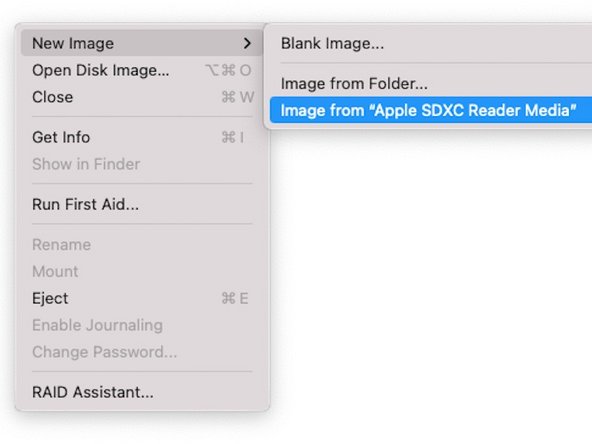

    • Now you need to create a Backup of the SD Card. You can use whatever software you like.
    • In the Screenshot, I'm using the built-in disk management of Linux Mint.
    • On Windows, you can use Programs like Win32DiskImager.
    • On macOS, you can use Disk Utility. Select the SD Card volume, click File > New Image > Image from "[SD Card volume name]"
    • On Windows & macOS, you will also get a bunch of messages urging you to format the partitions. Do not format any of them. It will irrecoverably brick your device!
    • It's not enough to copy-paste the files from the partitions that have been recognized in your Operating system. You have to use a tool to create an image of the entire card.

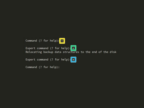

    • Now you have to fix an issue that is caused by copying the entirety of a small SD card onto a large one.
    • By pressing v you can verify the partition table on the SD card. It'll come up with one problem and one warning.
    • We can safely ignore the warning but have to deal with the problem.
    • To do that you press x to get into expert mode.
    • In expert mode, you can press e to apply the fix.
    • Afterward, you press m to get back to the main menu.
    • Pay attention to the command prompt, so you know which mode you're in. Buttons have different functions in different modes.
