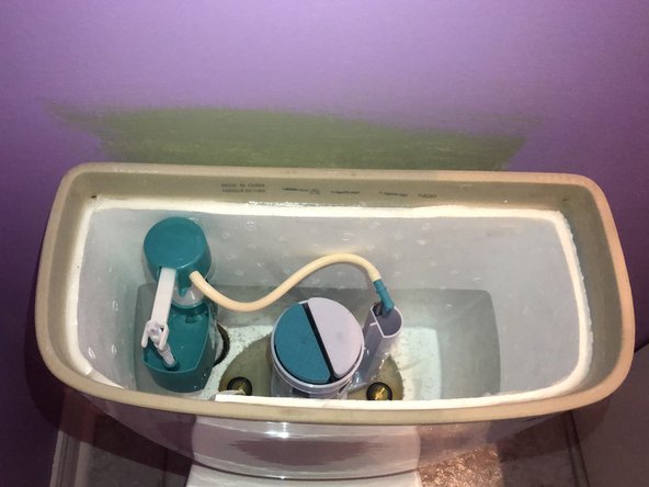

  2. Toilet Water Supply Line Replacement: crwdns2935265:03crwdnd2935265:01crwdnd2935265:02crwdne2935265:0 Toilet Water Supply Line Replacement: crwdns2935265:03crwdnd2935265:02crwdnd2935265:02crwdne2935265:0
    • Next, hold down the flush lever/button until all the water in the tank is drained from the tank.
    • A little water may still remain in the tank. You will need to remove this water as well.

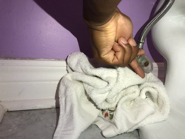

  3. Toilet Water Supply Line Replacement: crwdns2935265:04crwdnd2935265:01crwdnd2935265:01crwdne2935265:0
    • To remove any excess water from the tank. Place a container to catch the water that might drain by placing a bucket with a towel underneath the toilet to catch any water.

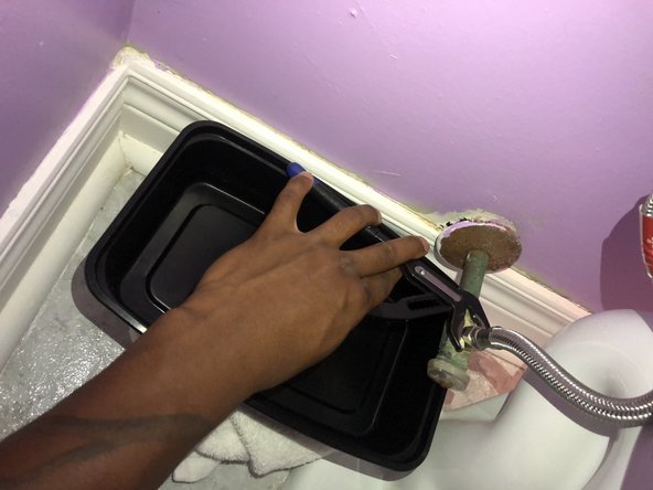

  4. Toilet Water Supply Line Replacement: crwdns2935265:05crwdnd2935265:01crwdnd2935265:03crwdne2935265:0 Toilet Water Supply Line Replacement: crwdns2935265:05crwdnd2935265:02crwdnd2935265:03crwdne2935265:0 Toilet Water Supply Line Replacement: crwdns2935265:05crwdnd2935265:03crwdnd2935265:03crwdne2935265:0
    • Use a vice grip to loosen the nut attached to the main waterline.
    • Use your hand to loosen the Bullock Nut attached to the toilet tank.
    • Get the bucket ready to catch any excess water from the toilet tank.

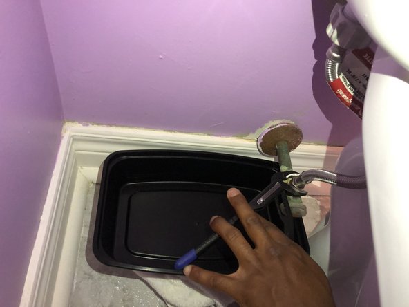

  5. Toilet Water Supply Line Replacement: crwdns2935265:06crwdnd2935265:01crwdnd2935265:02crwdne2935265:0 Toilet Water Supply Line Replacement: crwdns2935265:06crwdnd2935265:02crwdnd2935265:02crwdne2935265:0
    • Attach the nut of the new flex water supply line to the main water line.
    • Using your vice grips, tighten the nut counter-clockwise.

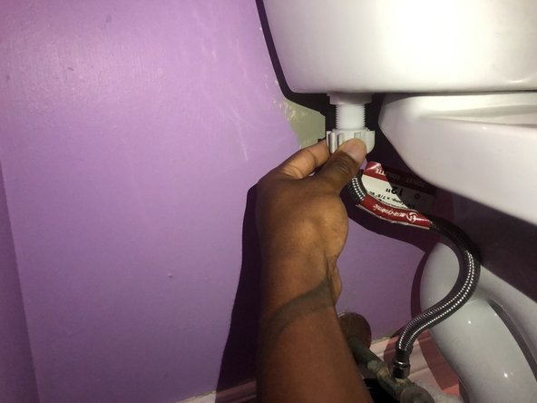

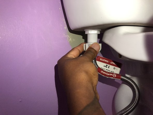

  6. Toilet Water Supply Line Replacement: crwdns2935265:07crwdnd2935265:01crwdnd2935265:02crwdne2935265:0 Toilet Water Supply Line Replacement: crwdns2935265:07crwdnd2935265:02crwdnd2935265:02crwdne2935265:0
    • Attach the Bullock Nut to the threads on the bottom of the toilet tank and hand tighten the nut counter-clockwise.
