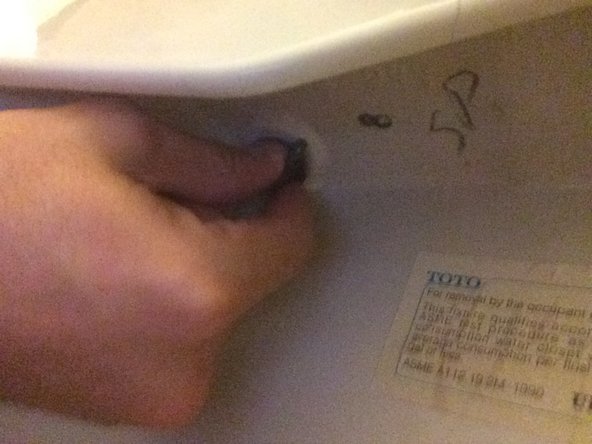

    • Twist the tops of the hinges of the currently installed toilet seat and pull toilet seat off to expose the screws.
  3. Toilet Seat Replacement: crwdns2935265:03crwdnd2935265:01crwdnd2935265:03crwdne2935265:0 Toilet Seat Replacement: crwdns2935265:03crwdnd2935265:02crwdnd2935265:03crwdne2935265:0 Toilet Seat Replacement: crwdns2935265:03crwdnd2935265:03crwdnd2935265:03crwdne2935265:0

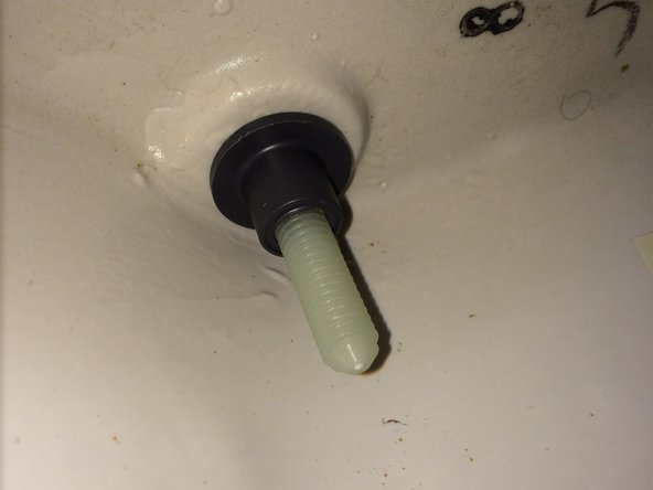

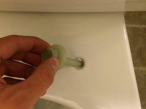

    • Unscrew the screws to detach the seat.
    • If the screw is not loosening but is spinning as if it were, then hold the back plastic nut so that it can unscrew from the nut.
    • Clean the newly exposed area. This opportunity will not present itself again anytime soon so take advantage of it.
  4. Toilet Seat Replacement: crwdns2935265:04crwdnd2935265:01crwdnd2935265:02crwdne2935265:0 Toilet Seat Replacement: crwdns2935265:04crwdnd2935265:02crwdnd2935265:02crwdne2935265:0
    • Insert new special 20mm screws that are provided with the purchase of the toilet seat in the holes and tighten them.
