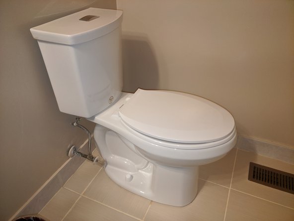

    • Spread a towel a bit behind you or beside if you have enough space, as this is where you will be placing the toilet.
  2. Toilet Flange Replacement: crwdns2935265:02crwdnd2935265:01crwdnd2935265:03crwdne2935265:0 Toilet Flange Replacement: crwdns2935265:02crwdnd2935265:02crwdnd2935265:03crwdne2935265:0 Toilet Flange Replacement: crwdns2935265:02crwdnd2935265:03crwdnd2935265:03crwdne2935265:0
    • Turn off the water line using the valve.
    • Disconnect the toilet water line from the back of the toilet (this looks like a hose).
    • Flush the toilet a few times to drain the tank.
  3. Toilet Flange Replacement: crwdns2935265:03crwdnd2935265:01crwdnd2935265:02crwdne2935265:0 Toilet Flange Replacement: crwdns2935265:03crwdnd2935265:02crwdnd2935265:02crwdne2935265:0

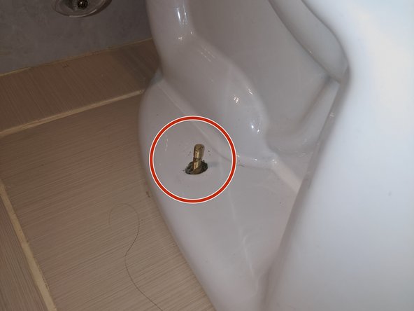

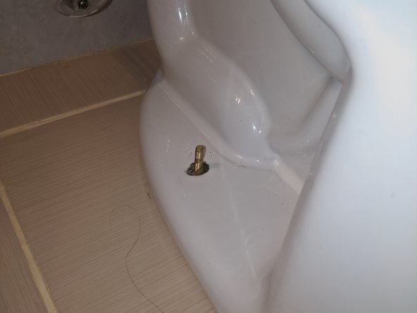

    • Remove the bolts on either side of the toilet, then gently remove it and lay it on the side. If there is not enough space, place it on a towel elsewhere. Take care as to ensure you do not accidentally scratch anything.
    • I used a monkey wrench to remove one of my bolts as they were held in place by excessive wax, but generally you should be able to remove them by hand.

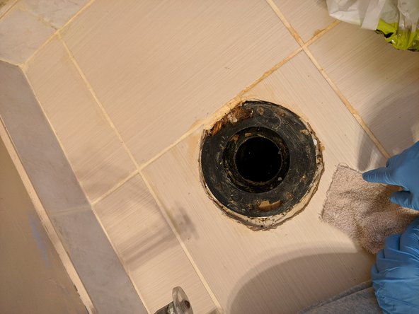

    • Scrape off the existing gasket (the wax ring at the bottom).
    • Optional: Place the new gasket where the previous gasket was after cleaning the spot where it originally was.
  5. Toilet Flange Replacement: crwdns2935265:05crwdnd2935265:01crwdnd2935265:01crwdne2935265:0
    • Drop in the new plate, and slide it until it is firmly in place. Make sure the bolts are standing up straight, and are not loose.
    • The kit I am using only repairs the holes for the bolts, but if you remove the whole flange, the new one simply drops and screws down into place.
