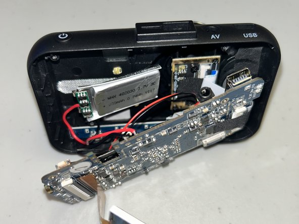

    • Use a suction handle to remove the screen from the camera.
    • Use an opening tool to pry off the bezel.
  2. Toguard C200 Camera Lens Replacement: crwdns2935265:02crwdnd2935265:01crwdnd2935265:01crwdne2935265:0
    • Lift the display assembly to the side, with care not to damage the ribbon cable.
    • Remove the four Phillips screws.
  3. Toguard C200 Camera Lens Replacement: crwdns2935265:03crwdnd2935265:01crwdnd2935265:02crwdne2935265:0 Toguard C200 Camera Lens Replacement: crwdns2935265:03crwdnd2935265:02crwdnd2935265:02crwdne2935265:0
    • Prop the motherboard out of the way.
    • Unscrew the four Phillips screws.
  4. Toguard C200 Camera Lens Replacement: crwdns2935265:04crwdnd2935265:01crwdnd2935265:01crwdne2935265:0
    • Remove the lens.
