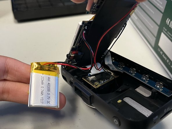

  4. Toguard C200 Battery Replacement: crwdns2935265:04crwdnd2935265:01crwdnd2935265:02crwdne2935265:0 Toguard C200 Battery Replacement: crwdns2935265:04crwdnd2935265:02crwdnd2935265:02crwdne2935265:0
    • Use the tweezers and your hands to remove the battery from its original place.
  5. Toguard C200 Battery Replacement: crwdns2935265:05crwdnd2935265:01crwdnd2935265:01crwdne2935265:0
    • Notice the connection of + and - on the top left side of the inside of the dash cam. Make note of this as it will be important to remember when you solder on the new battery
    • Desolder the old battery.
    • Heat the solder by using the soldering iron until it starts to melt. Try nudging the pins with the soldering iron to move the solder away from the joints. Pull the components you want to remove with the pliers.
    • Solder the new battery and make sure the + and - wires correctly match the motherboard. (Any super capacitor of 200mAh or higher will work)
