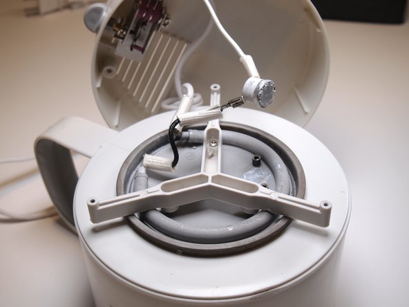

    • Remove the lid and flip the pot over.
  2. Toastmaster TMHP2 Disassembly: crwdns2935265:02crwdnd2935265:01crwdnd2935265:02crwdne2935265:0 Toastmaster TMHP2 Disassembly: crwdns2935265:02crwdnd2935265:02crwdnd2935265:02crwdne2935265:0
    • Use the plastic opening tool to remove the three rubber feet.
  3. Toastmaster TMHP2 Disassembly: crwdns2935265:03crwdnd2935265:01crwdnd2935265:02crwdne2935265:0 Toastmaster TMHP2 Disassembly: crwdns2935265:03crwdnd2935265:02crwdnd2935265:02crwdne2935265:0
    • Using the Phillips #1 screwdriver, remove the three 11 mm screws from the bottom of the device.
  4. Toastmaster TMHP2 Disassembly: crwdns2935265:04crwdnd2935265:01crwdnd2935265:02crwdne2935265:0 Toastmaster TMHP2 Disassembly: crwdns2935265:04crwdnd2935265:02crwdnd2935265:02crwdne2935265:0
    • Lift up the bottom cover to expose the internal wiring and components.
  5. Toastmaster TMHP2 Disassembly: crwdns2935265:05crwdnd2935265:01crwdnd2935265:03crwdne2935265:0 Toastmaster TMHP2 Disassembly: crwdns2935265:05crwdnd2935265:02crwdnd2935265:03crwdne2935265:0 Toastmaster TMHP2 Disassembly: crwdns2935265:05crwdnd2935265:03crwdnd2935265:03crwdne2935265:0
    • Using the Phillips #1 screwdriver, remove the two 8 mm screws securing the thermal switch.
    • Remove the bracket securing the thermal switch from the device.
  6. Toastmaster TMHP2 Disassembly: crwdns2935265:06crwdnd2935265:01crwdnd2935265:03crwdne2935265:0 Toastmaster TMHP2 Disassembly: crwdns2935265:06crwdnd2935265:02crwdnd2935265:03crwdne2935265:0 Toastmaster TMHP2 Disassembly: crwdns2935265:06crwdnd2935265:03crwdnd2935265:03crwdne2935265:0
    • Congratulations! You have disassembled the hot pot and can now see its internal compnents.
