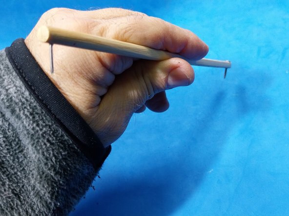

    • Homemade tool, for the repair of bread toasters, in this case it is the perforator for the mica sheet, which will allow us to insert a screw that will join the two ends of the Nicrom thread, split, it is the 3rd tool that I have made when in fact it should have been the first.
    • This is the most basic and simple to make, it is the first one we will use in the repair, it is made with a chopstick, a small wood screw and a small nail, both reinforced with instant dry glue.

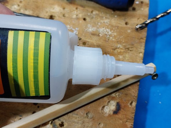

    • Inserting the nail, we must make the guide hole with the drill bit, this step is very important, otherwise the end of the stick will crack, before inserting the nail completely we will apply a drop of instant drying glue type cianolit so that it does not move with use.

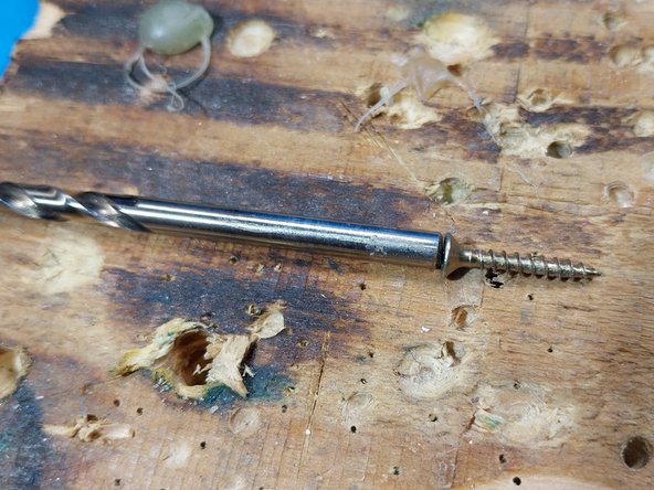

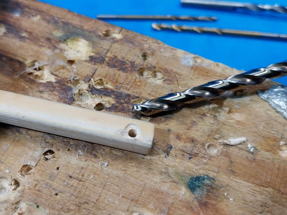

    • Now we will do the same with the screw, we will use a drill bit slightly smaller than the screw we have once the hole is drilled, with a drill bit of larger diameter (the size of the screw head) we will make a slight "countersink" so that the head when tightening the screw is embedded.

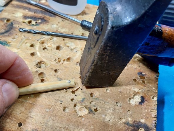

    • We place the screw and tighten it, and when there are 3 or 4 mm left to finish tightening, we apply a drop of instant dry cyanolit and we finish tightening.

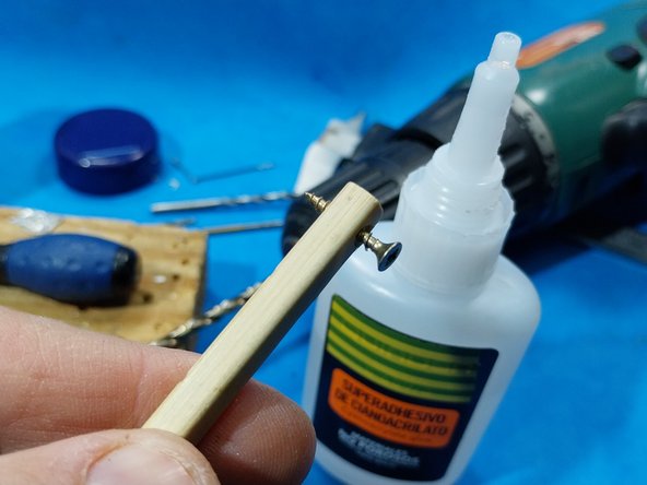

  6. Toaster repair - home built tools (Mica Plate Punch): crwdns2935265:06crwdnd2935265:01crwdnd2935265:01crwdne2935265:0
    • View of the inserted screw.
  7. Toaster repair - home built tools (Mica Plate Punch): crwdns2935265:07crwdnd2935265:01crwdnd2935265:03crwdne2935265:0 Toaster repair - home built tools (Mica Plate Punch): crwdns2935265:07crwdnd2935265:02crwdnd2935265:03crwdne2935265:0 Toaster repair - home built tools (Mica Plate Punch): crwdns2935265:07crwdnd2935265:03crwdnd2935265:03crwdne2935265:0
    • Images of the finished set.
  8. Toaster repair - home built tools (Mica Plate Punch): crwdns2935265:08crwdnd2935265:01crwdnd2935265:02crwdne2935265:0 Toaster repair - home built tools (Mica Plate Punch): crwdns2935265:08crwdnd2935265:02crwdnd2935265:02crwdne2935265:0
    • View of the finished homemade tool, useful to pierce the mica sheet at the point of breakage of the Nicrom thread in toasters and to be able to repair the thread. This tool is a complement of the following tools, being this the first one to be used to make the repair.
