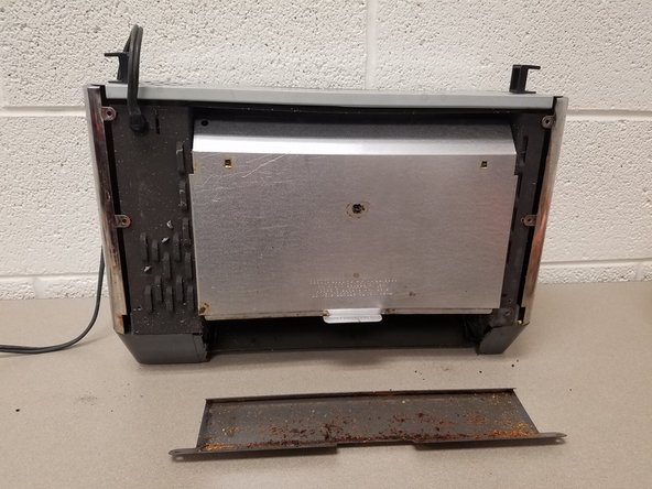

  3. Toaster Oven Toasting Knob Replacement: crwdns2935265:03crwdnd2935265:01crwdnd2935265:02crwdne2935265:0 Toaster Oven Toasting Knob Replacement: crwdns2935265:03crwdnd2935265:02crwdnd2935265:02crwdne2935265:0
    • Remove the two 4mm by 4mm screws from the base in order to remove the tray.

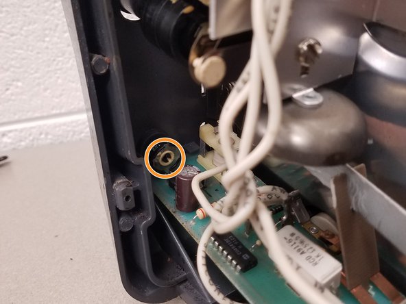

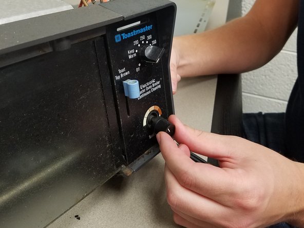

  6. Toaster Oven Toasting Knob Replacement: crwdns2935265:06crwdnd2935265:01crwdnd2935265:03crwdne2935265:0 Toaster Oven Toasting Knob Replacement: crwdns2935265:06crwdnd2935265:02crwdnd2935265:03crwdne2935265:0 Toaster Oven Toasting Knob Replacement: crwdns2935265:06crwdnd2935265:03crwdnd2935265:03crwdne2935265:0
    • The knob is missing in the first picture.
    • Push the knob into the hole.
    • The knob is now back in place in the last picture.
