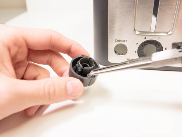

    • Detach the timer knob by pinching the sides of the timer knob and pushing towards the exterior of the toaster casing.

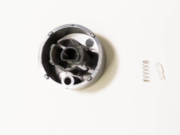

  10. Toaster Made by Design model KT-3215 Teardown: crwdns2935265:010crwdnd2935265:01crwdnd2935265:03crwdne2935265:0 Toaster Made by Design model KT-3215 Teardown: crwdns2935265:010crwdnd2935265:02crwdnd2935265:03crwdne2935265:0 Toaster Made by Design model KT-3215 Teardown: crwdns2935265:010crwdnd2935265:03crwdnd2935265:03crwdne2935265:0
    • Use a pair of mini long-nose pliers to remove the spring components from the timer knob.
