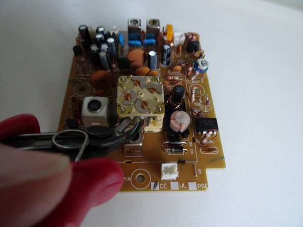

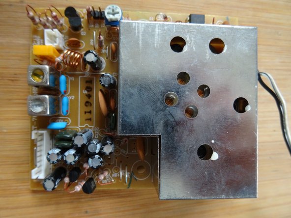

  5. Tivoli One Variable capacitor Repair, Unsoldering the shields: crwdns2935265:05crwdnd2935265:01crwdnd2935265:02crwdne2935265:0 Tivoli One Variable capacitor Repair, Unsoldering the shields: crwdns2935265:05crwdnd2935265:02crwdnd2935265:02crwdne2935265:0
    • This step is a bit tricky and tedious. Work very carefully and slowly. Mark the setting of the coupling with a felt pen.
    • Very carefully desolder the shields above the variable capacitor. Start with the flatter part on the back. There are ten solder joints on the front and back. Use a desoldering suction pump or desoldering braid. Remove the shields on the front and back.

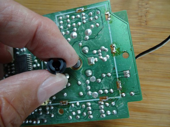

  6. Tivoli One Variable capacitor Repair, Remove the coupling: crwdns2935265:06crwdnd2935265:01crwdnd2935265:02crwdne2935265:0 Tivoli One Variable capacitor Repair, Remove the coupling: crwdns2935265:06crwdnd2935265:02crwdnd2935265:02crwdne2935265:0
    • Inside the black coupling piece there is a Phillips screw. Unscrew it. Remove the circlip, it is loose.
    • Carefully pull off the black coupling piece.

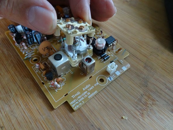

  9. Tivoli One Variable capacitor Repair, Unscrew the upper part: crwdns2935265:09crwdnd2935265:01crwdnd2935265:01crwdne2935265:0
    • Unscrew the four very small nuts that hold the capacitor together.
  10. Tivoli One Variable capacitor Repair, Lifting off the upper part: crwdns2935265:010crwdnd2935265:01crwdnd2935265:02crwdne2935265:0 Tivoli One Variable capacitor Repair, Lifting off the upper part: crwdns2935265:010crwdnd2935265:02crwdnd2935265:02crwdne2935265:0
    • Lift the upper part very carefully upwards.

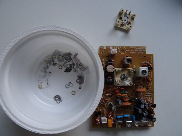

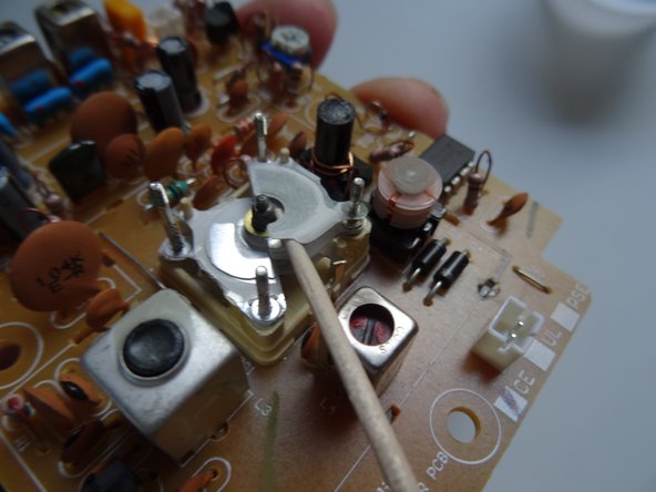

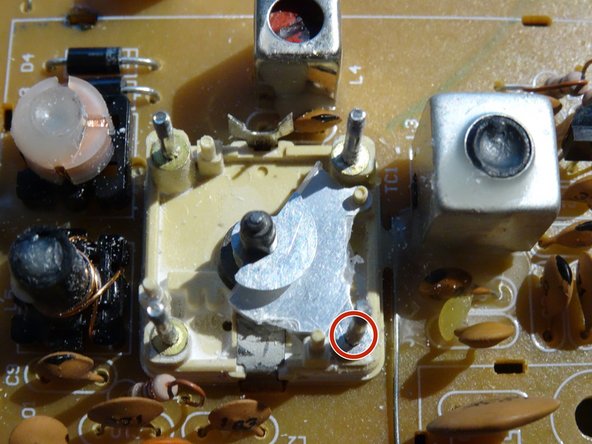

  12. Tivoli One Variable capacitor Repair, Disassemble the Variable Capacitor: crwdns2935265:012crwdnd2935265:01crwdnd2935265:03crwdne2935265:0 Tivoli One Variable capacitor Repair, Disassemble the Variable Capacitor: crwdns2935265:012crwdnd2935265:02crwdnd2935265:03crwdne2935265:0 Tivoli One Variable capacitor Repair, Disassemble the Variable Capacitor: crwdns2935265:012crwdnd2935265:03crwdnd2935265:03crwdne2935265:0
    • Here you can see the cause of the malfunction: the white separating agent between the plates of the capacitor has dried out. It must be removed. The lower plates are for FM, the upper ones for medium wave. The upper ones will not be needed later.
    • Slowly and patiently remove all the innards of the variable capacitor. A toothpick is good for this.
    • On the shaft are rotating rotors, fixed stators and washers. Other very small washers are on the upright posts
    • You don't need to sort the parts, that will come. But be careful not to lose or damage any of the very small parts.

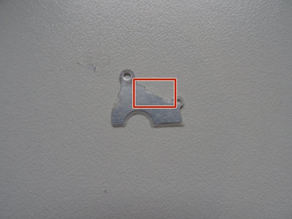

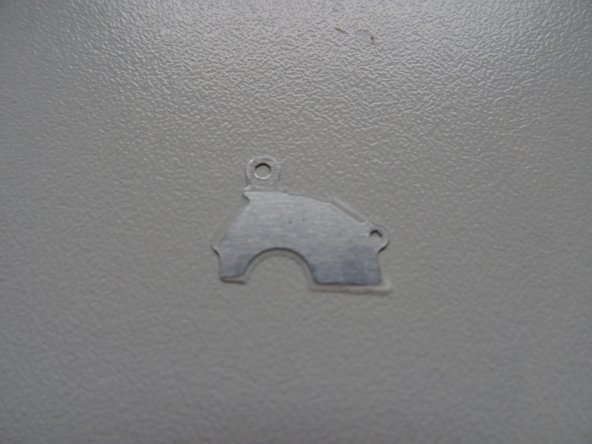

  13. Tivoli One Variable capacitor Repair, Necessary stators: crwdns2935265:013crwdnd2935265:01crwdnd2935265:02crwdne2935265:0 Tivoli One Variable capacitor Repair, Necessary stators: crwdns2935265:013crwdnd2935265:02crwdnd2935265:02crwdne2935265:0
    • There are four different types of stators. The two shown here are still needed. They can be recognized by the long indentation at the "back" (marked red):
    • 2 pieces type 1
    • 2 pieces type 2

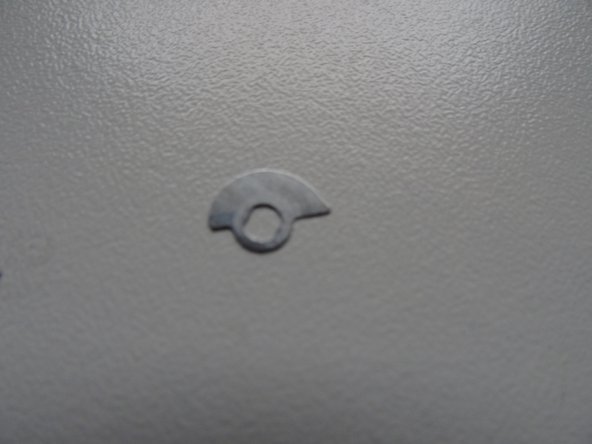

  14. Tivoli One Variable capacitor Repair, Unnecessary stators: crwdns2935265:014crwdnd2935265:01crwdnd2935265:02crwdne2935265:0 Tivoli One Variable capacitor Repair, Unnecessary stators: crwdns2935265:014crwdnd2935265:02crwdnd2935265:02crwdne2935265:0
    • The two shown here are for AM and will be omitted in the future:
    • 2 pieces type 3 with T-shaped eyelet on the right side
    • 4 pieces type 4 with short indentation at the back

  17. Tivoli One Variable capacitor Repair, Cleaning: crwdns2935265:017crwdnd2935265:01crwdnd2935265:01crwdne2935265:0
    • Now comes the cleaning work:
    • Push out the shaft. Clean the shaft and its contact ring (marked red) on the lower part of the condenser well with isopropyl alcohol, scrape off any corrosion.
    • Reinsert the shaft. The stop must be on the far right.
    • Clean the four required stators (type 1 and type 2), the six rotors and all disks well with isopropyl alcohol. Use a lint-free cotton swab for this purpose.

  24. Tivoli One Variable capacitor Repair, Soldering the shields: crwdns2935265:024crwdnd2935265:01crwdnd2935265:02crwdne2935265:0 Tivoli One Variable capacitor Repair, Soldering the shields: crwdns2935265:024crwdnd2935265:02crwdnd2935265:02crwdne2935265:0
    • Solder the two shields again, a few solder points are sufficient.
    • Put the tuner board on and fix it with the three screws. Play a bit with the adjustment knob until the coupling fits.

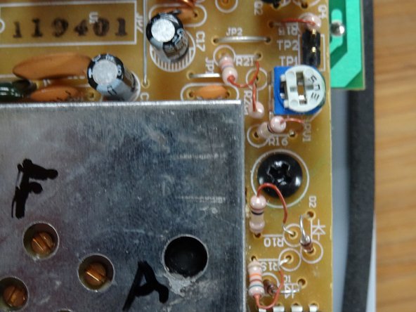

  25. Tivoli One Variable capacitor Repair, Settings and assembly: crwdns2935265:025crwdnd2935265:01crwdnd2935265:01crwdne2935265:0
    • The dial marked F controls the frequency. Set the dial to the frequency of a known station at about 100 MHz, use a second radio and adjust until the desired station can be heard clearly on both radios.
    • Set a weaker station at about 100 MHz and adjust with A to best volume.
    • This potentiometer allows you to adjust the LED transmitter setting to the optimum level. Set a strong transmitter and adjust the yellow LED to highest brightness.
