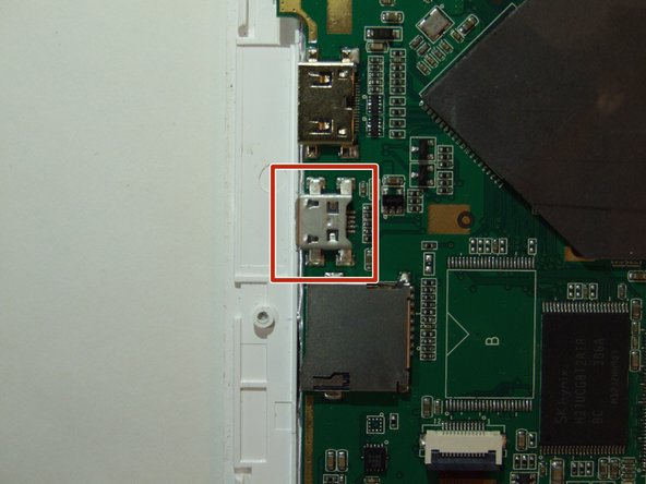

  10. Tivax MiTraveler 10Q-8 USB Charging Port Replacement, USB Charging Port: crwdns2935265:010crwdnd2935265:01crwdnd2935265:02crwdne2935265:0 Tivax MiTraveler 10Q-8 USB Charging Port Replacement, USB Charging Port: crwdns2935265:010crwdnd2935265:02crwdnd2935265:02crwdne2935265:0
    • With the device facing down, the USB charging port can be located on the left side of the device directly on the motherboard. The mini HDMI port will be above the charging port and the micro SD port will be below, with the charging port in the middle of the two.
    • Make sure all power is extinguished by following the steps to remove the battery.
    • The charging port will be soldered down at all four corners; each prong will need to be soldered off.
    • Review How to Solder Here

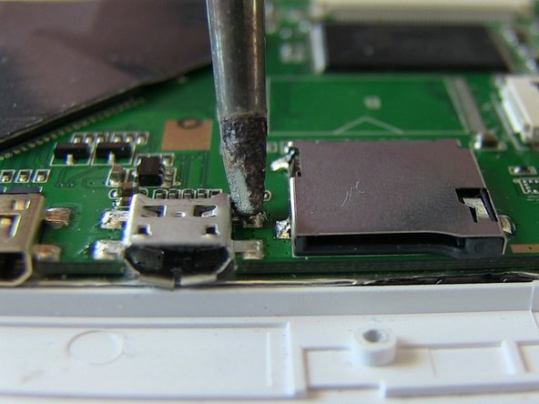

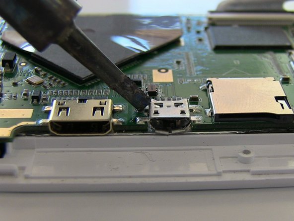

  11. Tivax MiTraveler 10Q-8 USB Charging Port Replacement: crwdns2935265:011crwdnd2935265:01crwdnd2935265:03crwdne2935265:0 Tivax MiTraveler 10Q-8 USB Charging Port Replacement: crwdns2935265:011crwdnd2935265:02crwdnd2935265:03crwdne2935265:0 Tivax MiTraveler 10Q-8 USB Charging Port Replacement: crwdns2935265:011crwdnd2935265:03crwdnd2935265:03crwdne2935265:0
    • Work the iron on one prong at a time that is soldered to the motherboard. The USB port will release from the motherboard.

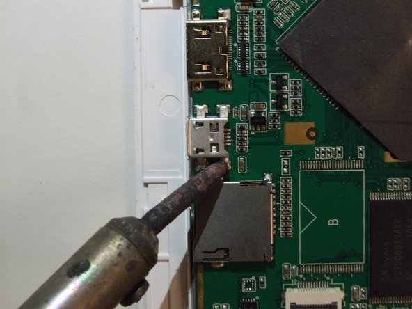

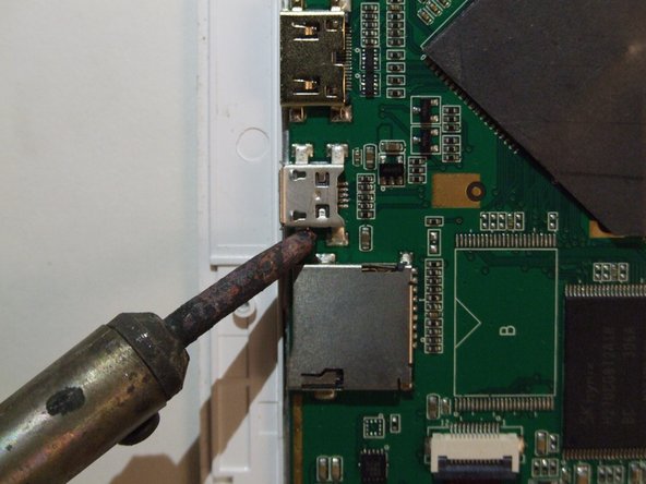

  12. Tivax MiTraveler 10Q-8 USB Charging Port Replacement: crwdns2935265:012crwdnd2935265:01crwdnd2935265:03crwdne2935265:0 Tivax MiTraveler 10Q-8 USB Charging Port Replacement: crwdns2935265:012crwdnd2935265:02crwdnd2935265:03crwdne2935265:0 Tivax MiTraveler 10Q-8 USB Charging Port Replacement: crwdns2935265:012crwdnd2935265:03crwdnd2935265:03crwdne2935265:0
    • Repeat steps 2-5 for the soldering of the other 3 prongs.
    • Once all four prongs have been soldered off the USB charging port will remove from the device.
