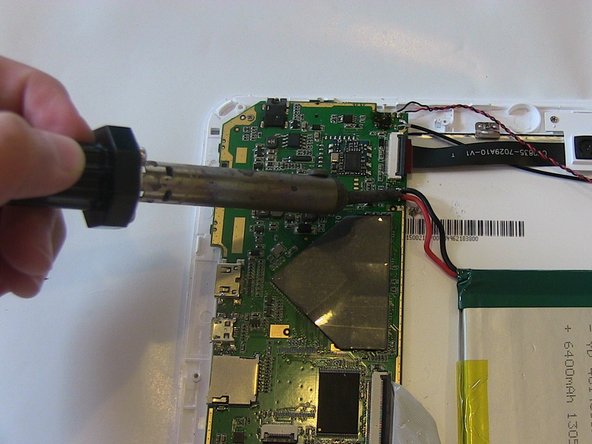

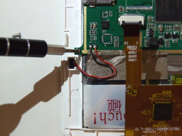

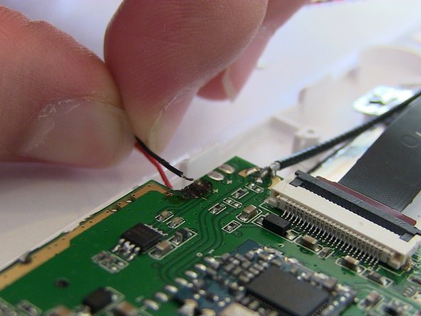

    • Two wires, one red and one black, which run from the motherboard to the battery, need to be desoldered from the motherboard.
    • Review how to solder here.
  8. Tivax MiTraveler 10Q-8 Motherboard Replacement: crwdns2935265:08crwdnd2935265:01crwdnd2935265:02crwdne2935265:0 Tivax MiTraveler 10Q-8 Motherboard Replacement: crwdns2935265:08crwdnd2935265:02crwdnd2935265:02crwdne2935265:0
    • Work the soldering gun on the red wire where it is connected to the motherboard. It should release from the motherboard.
    • Work the soldering gun on the black wire where it is connected to the motherboard. It will release from the motherboard.

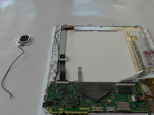

  10. Tivax MiTraveler 10Q-8 Motherboard Replacement, Speaker: crwdns2935265:010crwdnd2935265:01crwdnd2935265:01crwdne2935265:0

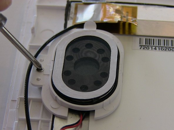

    • With the face of the device down, locate the speaker in the upper right corner.
    • Make sure the battery has been removed.
  11. Tivax MiTraveler 10Q-8 Motherboard Replacement: crwdns2935265:011crwdnd2935265:01crwdnd2935265:02crwdne2935265:0 Tivax MiTraveler 10Q-8 Motherboard Replacement: crwdns2935265:011crwdnd2935265:02crwdnd2935265:02crwdne2935265:0
    • Remove the 3.9 mm screw holding the speaker in place using a Phillips #000 screwdriver.
  12. Tivax MiTraveler 10Q-8 Motherboard Replacement: crwdns2935265:012crwdnd2935265:01crwdnd2935265:02crwdne2935265:0 Tivax MiTraveler 10Q-8 Motherboard Replacement: crwdns2935265:012crwdnd2935265:02crwdnd2935265:02crwdne2935265:0

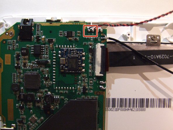

    • The speaker will be connected to two wires; one black and one red. Both run to the motherboard.
    • The wires will need to be soldered off the motherboard.
    • Locate where both wires are soldered to the motherboard.
    • Review How to Solder Here
  13. Tivax MiTraveler 10Q-8 Motherboard Replacement: crwdns2935265:013crwdnd2935265:01crwdnd2935265:02crwdne2935265:0 Tivax MiTraveler 10Q-8 Motherboard Replacement: crwdns2935265:013crwdnd2935265:02crwdnd2935265:02crwdne2935265:0

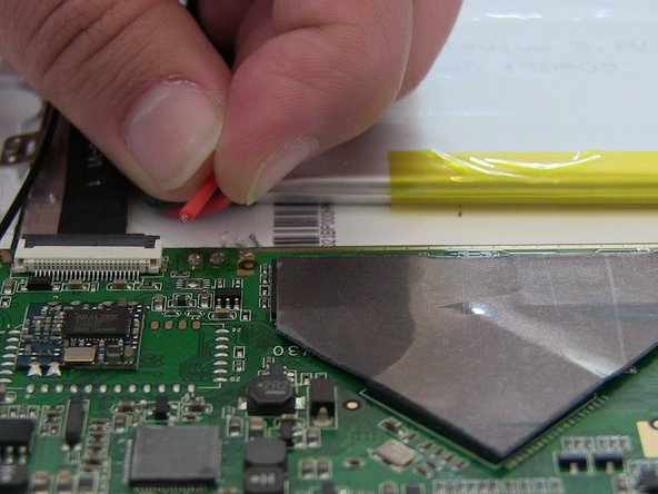

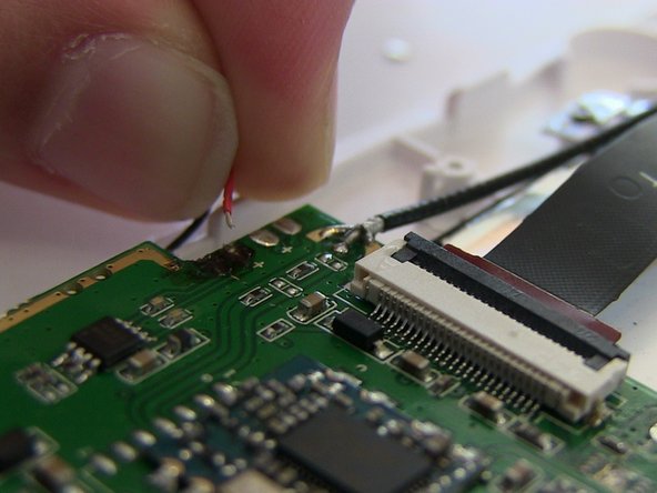

    • Work the iron where the red wire is soldered.
    • The wire will release from the motherboard.
  14. Tivax MiTraveler 10Q-8 Motherboard Replacement: crwdns2935265:014crwdnd2935265:01crwdnd2935265:03crwdne2935265:0 Tivax MiTraveler 10Q-8 Motherboard Replacement: crwdns2935265:014crwdnd2935265:02crwdnd2935265:03crwdne2935265:0 Tivax MiTraveler 10Q-8 Motherboard Replacement: crwdns2935265:014crwdnd2935265:03crwdnd2935265:03crwdne2935265:0

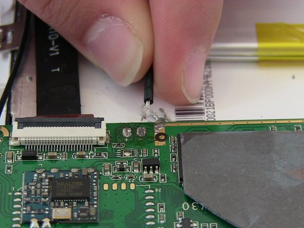

    • Work the iron where the black wire is soldered.
    • The black wire will release from the motherboard.
    • After both wires have been soldered off, the speaker will release from the device.

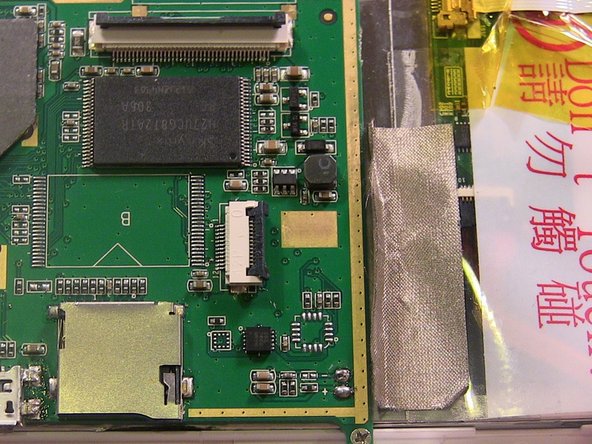

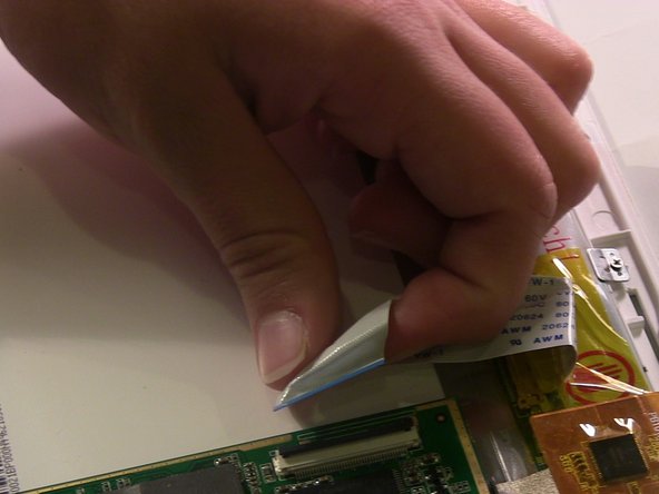

    • Remove the white ribbon connector from the motherboard.
  17. Tivax MiTraveler 10Q-8 Motherboard Replacement: crwdns2935265:017crwdnd2935265:01crwdnd2935265:02crwdne2935265:0 Tivax MiTraveler 10Q-8 Motherboard Replacement: crwdns2935265:017crwdnd2935265:02crwdnd2935265:02crwdne2935265:0
    • Remove the orange ribbon connector from the motherboard.
  18. Tivax MiTraveler 10Q-8 Motherboard Replacement: crwdns2935265:018crwdnd2935265:01crwdnd2935265:02crwdne2935265:0 Tivax MiTraveler 10Q-8 Motherboard Replacement: crwdns2935265:018crwdnd2935265:02crwdnd2935265:02crwdne2935265:0

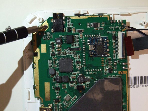

    • Locate a 2.88 mm Phillips head screw in the upper right hand corner of the mother board.
    • Use a #00 screw driver with the PH000 screw head to remove the screw.

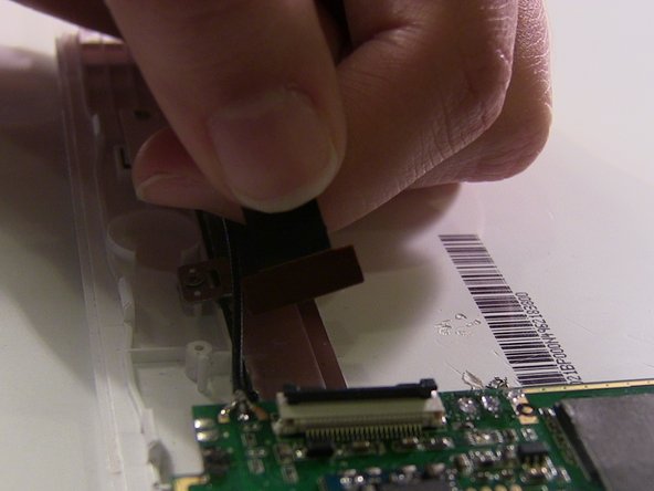

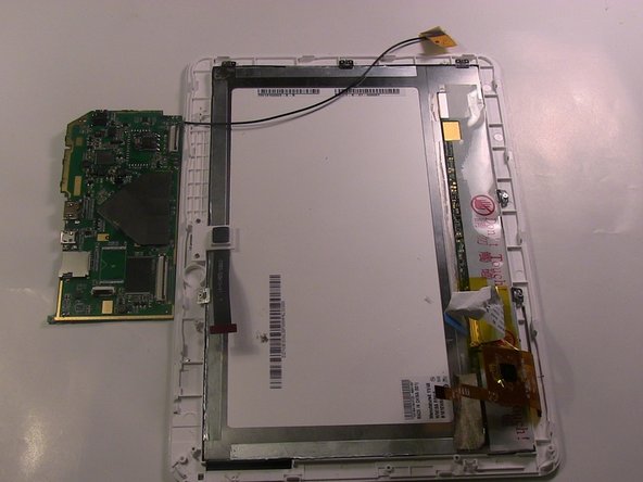

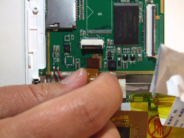

    • Locate a strip of gold tape, which holds it to the device, on the bottom of the motherboard.
  21. Tivax MiTraveler 10Q-8 Motherboard Replacement: crwdns2935265:021crwdnd2935265:01crwdnd2935265:02crwdne2935265:0 Tivax MiTraveler 10Q-8 Motherboard Replacement: crwdns2935265:021crwdnd2935265:02crwdnd2935265:02crwdne2935265:0
    • On the upper right hand corner of the device, a black wire connects to the device and runs to a strip of orange tape.
    • Remove the tape that holds the wire down.
    • Remove the motherboard from the device.
