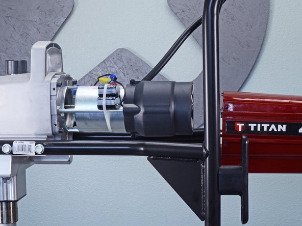

  2. Titan Airless Sprayer IMPACT 410 Capacitor Replacement, Unfasten the motor cover: crwdns2935265:02crwdnd2935265:01crwdnd2935265:02crwdne2935265:0 Titan Airless Sprayer IMPACT 410 Capacitor Replacement, Unfasten the motor cover: crwdns2935265:02crwdnd2935265:02crwdnd2935265:02crwdne2935265:0
    • Use a Phillips driver to remove the four 12 mm-long screws (two on either side) securing the motor cover.
  3. Titan Airless Sprayer IMPACT 410 Capacitor Replacement, Remove the motor cover: crwdns2935265:03crwdnd2935265:01crwdnd2935265:03crwdne2935265:0 Titan Airless Sprayer IMPACT 410 Capacitor Replacement, Remove the motor cover: crwdns2935265:03crwdnd2935265:02crwdnd2935265:03crwdne2935265:0 Titan Airless Sprayer IMPACT 410 Capacitor Replacement, Remove the motor cover: crwdns2935265:03crwdnd2935265:03crwdnd2935265:03crwdne2935265:0
    • Pull the motor cover straight off the motor.

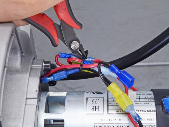

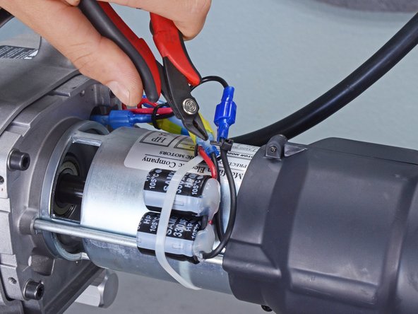

  4. Titan Airless Sprayer IMPACT 410 Capacitor Replacement, Isolate the capacitor wires: crwdns2935265:04crwdnd2935265:01crwdnd2935265:03crwdne2935265:0 Titan Airless Sprayer IMPACT 410 Capacitor Replacement, Isolate the capacitor wires: crwdns2935265:04crwdnd2935265:02crwdnd2935265:03crwdne2935265:0 Titan Airless Sprayer IMPACT 410 Capacitor Replacement, Isolate the capacitor wires: crwdns2935265:04crwdnd2935265:03crwdnd2935265:03crwdne2935265:0
    • Use diagonal cutters, or scissors, to cut the two cable ties bundling the capacitor's positive and negative wires.
    • During reassembly, replace the cable ties.

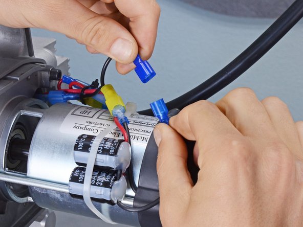

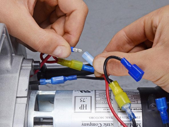

  5. Titan Airless Sprayer IMPACT 410 Capacitor Replacement, Disconnect the negative wire: crwdns2935265:05crwdnd2935265:01crwdnd2935265:02crwdne2935265:0 Titan Airless Sprayer IMPACT 410 Capacitor Replacement, Disconnect the negative wire: crwdns2935265:05crwdnd2935265:02crwdnd2935265:02crwdne2935265:0
    • Disconnect the black negative wire's spade connector.
    • Always grip cables by their connectors and not the wires themselves.
  6. Titan Airless Sprayer IMPACT 410 Capacitor Replacement, Disconnect the positive wire: crwdns2935265:06crwdnd2935265:01crwdnd2935265:02crwdne2935265:0 Titan Airless Sprayer IMPACT 410 Capacitor Replacement, Disconnect the positive wire: crwdns2935265:06crwdnd2935265:02crwdnd2935265:02crwdne2935265:0
    • Disconnect the red positive wire's bullet connector.

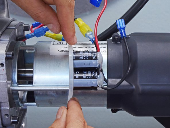

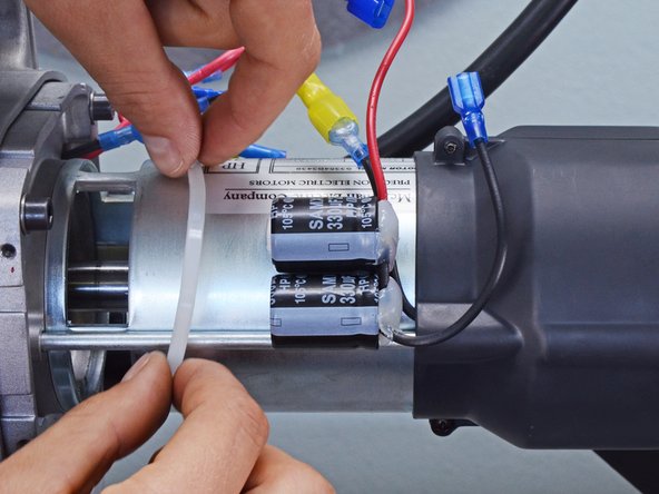

  7. Titan Airless Sprayer IMPACT 410 Capacitor Replacement, Isolate the capacitor: crwdns2935265:07crwdnd2935265:01crwdnd2935265:03crwdne2935265:0 Titan Airless Sprayer IMPACT 410 Capacitor Replacement, Isolate the capacitor: crwdns2935265:07crwdnd2935265:02crwdnd2935265:03crwdne2935265:0 Titan Airless Sprayer IMPACT 410 Capacitor Replacement, Isolate the capacitor: crwdns2935265:07crwdnd2935265:03crwdnd2935265:03crwdne2935265:0
    • Grip the cable tie and slide it off the capacitors.

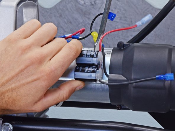

  9. Titan Airless Sprayer IMPACT 410 Capacitor Replacement, Remove the capacitors: crwdns2935265:09crwdnd2935265:01crwdnd2935265:02crwdne2935265:0 Titan Airless Sprayer IMPACT 410 Capacitor Replacement, Remove the capacitors: crwdns2935265:09crwdnd2935265:02crwdnd2935265:02crwdne2935265:0

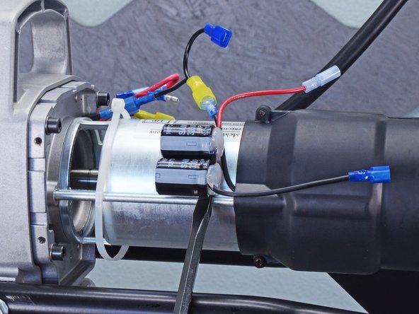

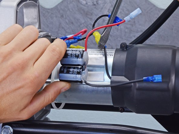

    • The capacitors are lightly adhered to the motor body.
    • Insert a flathead screwdriver underneath the capacitors, between the bottom cell and the adhesive.
    • Pry up to separate the bottom cell from the motor body.
  10. Titan Airless Sprayer IMPACT 410 Capacitor Replacement: crwdns2935265:010crwdnd2935265:01crwdnd2935265:03crwdne2935265:0 Titan Airless Sprayer IMPACT 410 Capacitor Replacement: crwdns2935265:010crwdnd2935265:02crwdnd2935265:03crwdne2935265:0 Titan Airless Sprayer IMPACT 410 Capacitor Replacement: crwdns2935265:010crwdnd2935265:03crwdnd2935265:03crwdne2935265:0
    • Insert a flathead screwdriver underneath the capacitors, between the top cell and the adhesive.
    • Pry up to separate the rest of the capacitor from the motor body.
    • Remove the capacitor.
    • During reassembly, if the adhesive is no longer sticky, replace it with double-sided foam adhesive.
