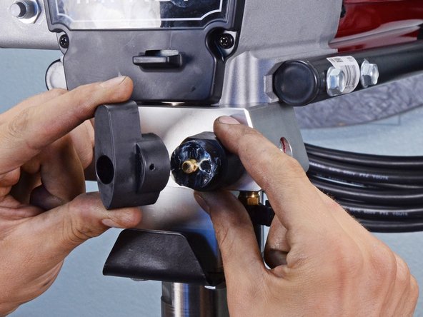

  3. Titan Airless Sprayer IMPACT 410 Bypass Valve Assembly Replacement: crwdns2935265:03crwdnd2935265:01crwdnd2935265:02crwdne2935265:0 Titan Airless Sprayer IMPACT 410 Bypass Valve Assembly Replacement: crwdns2935265:03crwdnd2935265:02crwdnd2935265:02crwdne2935265:0
    • Remove the valve handle from the cam base.
    • During reassembly, apply grease to the cam base before reattaching the valve handle.

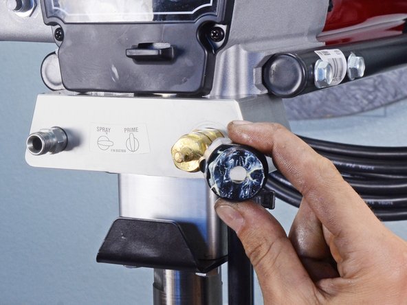

  4. Titan Airless Sprayer IMPACT 410 Bypass Valve Assembly Replacement, Remove the cam base: crwdns2935265:04crwdnd2935265:01crwdnd2935265:03crwdne2935265:0 Titan Airless Sprayer IMPACT 410 Bypass Valve Assembly Replacement, Remove the cam base: crwdns2935265:04crwdnd2935265:02crwdnd2935265:03crwdne2935265:0 Titan Airless Sprayer IMPACT 410 Bypass Valve Assembly Replacement, Remove the cam base: crwdns2935265:04crwdnd2935265:03crwdnd2935265:03crwdne2935265:0
    • Remove the cam base.

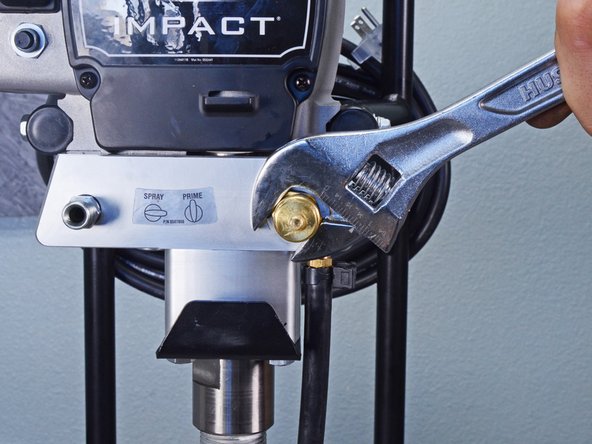

  5. Titan Airless Sprayer IMPACT 410 Bypass Valve Assembly Replacement, Loosen the bypass valve assembly: crwdns2935265:05crwdnd2935265:01crwdnd2935265:02crwdne2935265:0 Titan Airless Sprayer IMPACT 410 Bypass Valve Assembly Replacement, Loosen the bypass valve assembly: crwdns2935265:05crwdnd2935265:02crwdnd2935265:02crwdne2935265:0
    • Use a 13/16" wrench, or an adjustable wrench, to loosen the bypass valve assembly.
    • Rotate the wrench counterclockwise.

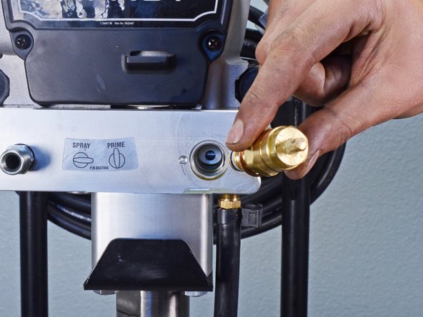

  6. Titan Airless Sprayer IMPACT 410 Bypass Valve Assembly Replacement, Remove the bypass valve assembly: crwdns2935265:06crwdnd2935265:01crwdnd2935265:02crwdne2935265:0 Titan Airless Sprayer IMPACT 410 Bypass Valve Assembly Replacement, Remove the bypass valve assembly: crwdns2935265:06crwdnd2935265:02crwdnd2935265:02crwdne2935265:0
