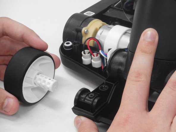

  3. Tineco FLOOR ONE S3 Breeze Motor Replacement: crwdns2935265:03crwdnd2935265:01crwdnd2935265:02crwdne2935265:0 Tineco FLOOR ONE S3 Breeze Motor Replacement: crwdns2935265:03crwdnd2935265:02crwdnd2935265:02crwdne2935265:0
    • Remove two 10.6 mm screws holding the wheels in place with a Phillips #1 screwdriver.
    • Remove the wheels.
    • The wheels do not need to be removed to access the motor.
