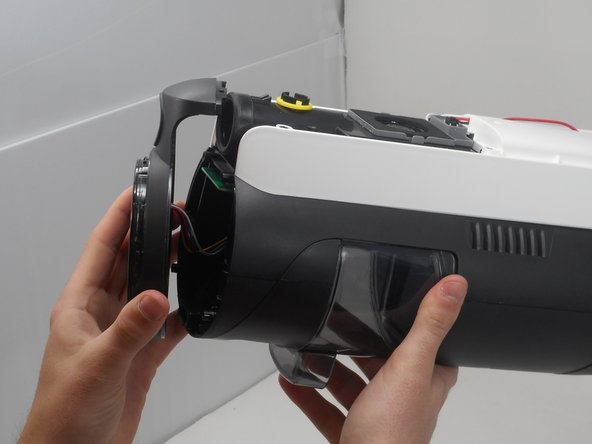

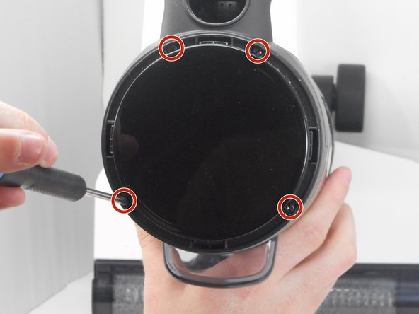

    • Pry open and remove the black ring at the top of the vacuum using by using an opening tool.
    • Remove four 10.6 mm screws located underneath the previously pried ring using a Phillips #1 screwdriver.
    • Remove the top circular piece from the body of the vacuum.

    • Remove the white back piece of the vacuum.

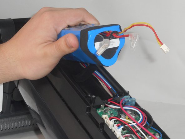

    • Unplug the wires of the battery by carefully pulling them up from the motherboard.
    • Slide the battery out of its slot and replace it with the new battery.
    • The connection may be difficult to remove. Be careful not to rip the entire connector from the motherboard.

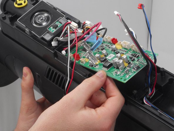

  6. Tineco FLOOR ONE S3 Breeze Motherboard Replacement, Motherboard: crwdns2935265:06crwdnd2935265:01crwdnd2935265:01crwdne2935265:0
    • Carefully remove all the wire connections from the motherboard.
    • Take note of where and how the wires were connected, so they can be rewired to the new motherboard.
  7. Tineco FLOOR ONE S3 Breeze Motherboard Replacement: crwdns2935265:07crwdnd2935265:01crwdnd2935265:02crwdne2935265:0 Tineco FLOOR ONE S3 Breeze Motherboard Replacement: crwdns2935265:07crwdnd2935265:02crwdnd2935265:02crwdne2935265:0
    • Remove the four 10.6 mm screws holding the motherboard using a Phillips #1 screwdriver.
    • Carefully remove the motherboard from the vacuum.
