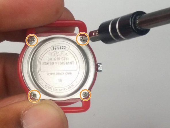

  3. Timex W-10 Children's Watch Battery Replacement: crwdns2935265:03crwdnd2935265:01crwdnd2935265:02crwdne2935265:0 Timex W-10 Children's Watch Battery Replacement: crwdns2935265:03crwdnd2935265:02crwdnd2935265:02crwdne2935265:0
    • Use the PH00 screwdriver to remove the four screws from each corner of the rear metal cover.
  4. Timex W-10 Children's Watch Battery Replacement: crwdns2935265:04crwdnd2935265:01crwdnd2935265:02crwdne2935265:0 Timex W-10 Children's Watch Battery Replacement: crwdns2935265:04crwdnd2935265:02crwdnd2935265:02crwdne2935265:0
    • Gently remove the back plate to expose the battery.
  5. Timex W-10 Children's Watch Battery Replacement: crwdns2935265:05crwdnd2935265:01crwdnd2935265:02crwdne2935265:0 Timex W-10 Children's Watch Battery Replacement: crwdns2935265:05crwdnd2935265:02crwdnd2935265:02crwdne2935265:0
    • The battery spring will propel the battery upward as soon as the base cover is removed. Be sure to place the battery in a safe spot.
