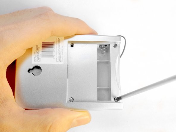

    • Loosen and remove the four screws from the back of the thermometer.

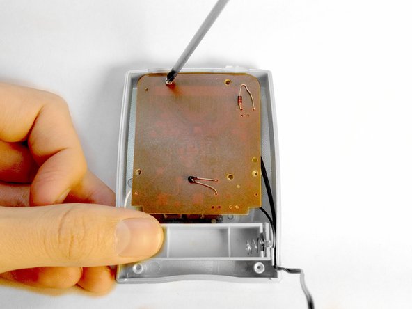

    • Remove the three screws holding the circuit board in place.

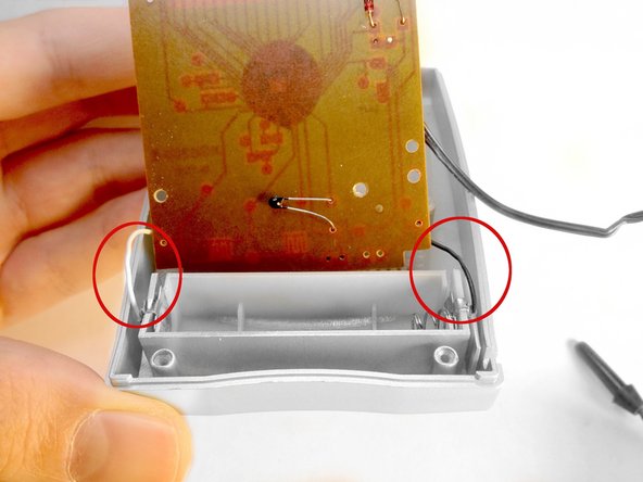

    • Lift the circuit board away from the case.
    • Be careful not to pull too hard as the board is attached to the battery contacts.

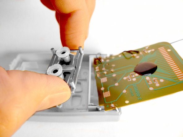

    • Remove the screen from its compartment.
    • Remove the push buttons from their compartment.
