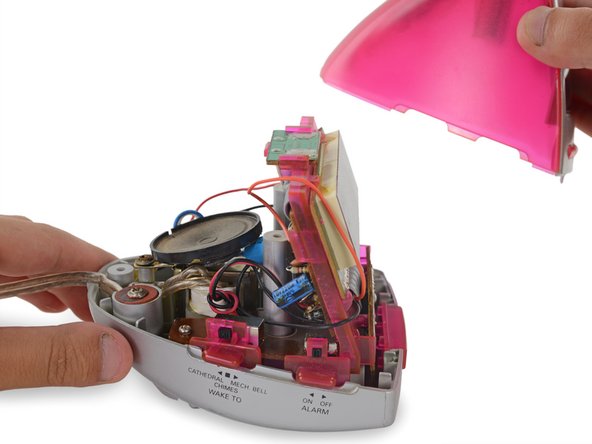

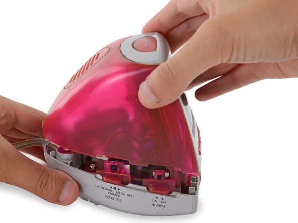

  5. Timex T132 "iMac" Alarm Clock Disassembly: crwdns2935265:05crwdnd2935265:01crwdnd2935265:03crwdne2935265:0 Timex T132 "iMac" Alarm Clock Disassembly: crwdns2935265:05crwdnd2935265:02crwdnd2935265:03crwdne2935265:0 Timex T132 "iMac" Alarm Clock Disassembly: crwdns2935265:05crwdnd2935265:03crwdnd2935265:03crwdne2935265:0
    • Support the base and top cover of the clock.
    • Turn over the clock and place it base-down on a flat surface.
    • Support the back of the base with one hand and grasp the housing with the other.
    • Lift and separate the housing from the base of the clock.
    • You may have to wiggle the housing prior to lifting it.

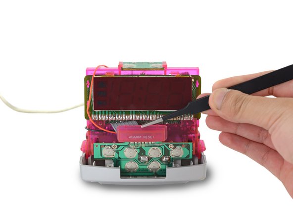

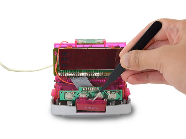

  6. Timex T132 "iMac" Alarm Clock Disassembly: crwdns2935265:06crwdnd2935265:01crwdnd2935265:03crwdne2935265:0 Timex T132 "iMac" Alarm Clock Disassembly: crwdns2935265:06crwdnd2935265:02crwdnd2935265:03crwdne2935265:0 Timex T132 "iMac" Alarm Clock Disassembly: crwdns2935265:06crwdnd2935265:03crwdnd2935265:03crwdne2935265:0
    • Rotate the clock so you are viewing the LCD display.
    • Use your fingers or the tweezers to secure the lip of the ALARM RESET button located at the middle of the base and remove the button from its compartment.
