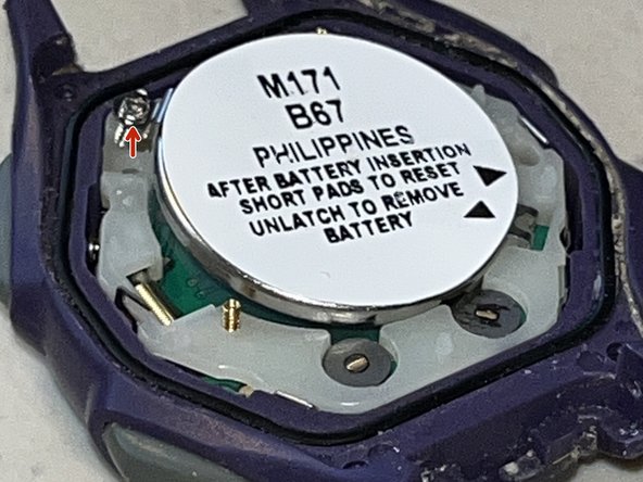

  3. Timex Ironman Triathlon Battery Replacement, Removing Contact-Plate: crwdns2935265:03crwdnd2935265:01crwdnd2935265:03crwdne2935265:0 Timex Ironman Triathlon Battery Replacement, Removing Contact-Plate: crwdns2935265:03crwdnd2935265:02crwdnd2935265:03crwdne2935265:0 Timex Ironman Triathlon Battery Replacement, Removing Contact-Plate: crwdns2935265:03crwdnd2935265:03crwdnd2935265:03crwdne2935265:0
    • Use JIS #000 Bit to unscrew the screw that secures the 2025 coin-cell battery underneath the white sticker.
    • Remove the screw from the eyelet, and place it to the side in a safe place.

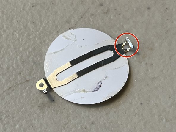

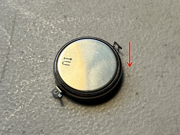

  4. Timex Ironman Triathlon Battery Replacement: crwdns2935265:04crwdnd2935265:01crwdnd2935265:03crwdne2935265:0 Timex Ironman Triathlon Battery Replacement: crwdns2935265:04crwdnd2935265:02crwdnd2935265:03crwdne2935265:0 Timex Ironman Triathlon Battery Replacement: crwdns2935265:04crwdnd2935265:03crwdnd2935265:03crwdne2935265:0
    • Carefully lift contact-bracket up and peel dead battery off, for recycling.
    • Unlatch the empty contact-bracket by gently lifting the bracket up, off, and away from the plastic knuckle that is holding it onto the body of the watch.
    • Place contact-bracket face-up on a secure surface.
    • Place the positive(+) side of the new battery facing down on the contact-bracket.

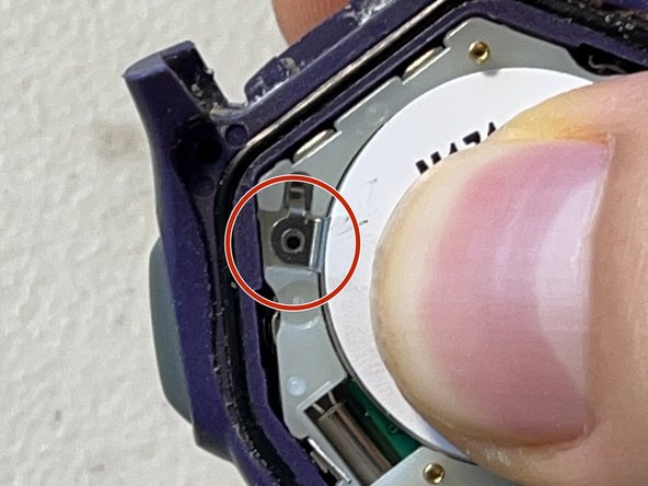

  5. Timex Ironman Triathlon Battery Replacement, Secure New Battery: crwdns2935265:05crwdnd2935265:01crwdnd2935265:02crwdne2935265:0 Timex Ironman Triathlon Battery Replacement, Secure New Battery: crwdns2935265:05crwdnd2935265:02crwdnd2935265:02crwdne2935265:0
    • Carefully replace contact-bracket by hanging the metal latch over the plastic knuckle.
    • Tighten screw.
    • Reset system settings by touching both gold pins with a conductive tool, such as the tip of a small Flathead screwdriver, or tweezers.
