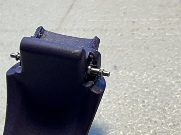

    • Use small flat tool such as a Flathead screwdriver to press the metal "spring bars" inward, one at a time, to release the wrist-band from the "Lugs."
    • Repeat first step on opposite side.
