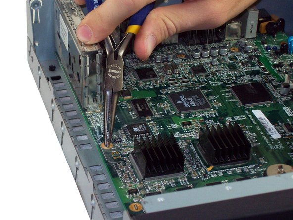

  9. TiVo Series 2 TCD24008A Motherboard Replacement: crwdns2935265:09crwdnd2935265:01crwdnd2935265:02crwdne2935265:0 TiVo Series 2 TCD24008A Motherboard Replacement: crwdns2935265:09crwdnd2935265:02crwdnd2935265:02crwdne2935265:0
    • Locate the four metal tabs on the motherboard.
    • Using Pliers, bend each of the tabs until they align straight with the holes underneath them.
    • Bend these just enough to slip them through the holes. Over-bending could snap these tabs. While this won't affect how the TiVo functions, they are there to secure the motherboard to prevent damage.

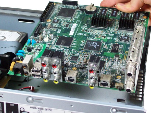

  11. TiVo Series 2 TCD24008A Motherboard Replacement: crwdns2935265:011crwdnd2935265:01crwdnd2935265:02crwdne2935265:0 TiVo Series 2 TCD24008A Motherboard Replacement: crwdns2935265:011crwdnd2935265:02crwdnd2935265:02crwdne2935265:0
    • Pull directly up on the motherboard so that it slips over the four golden metal tabs.
    • Pull up and away from the back panel so all of the cable inputs slip through the casing.
