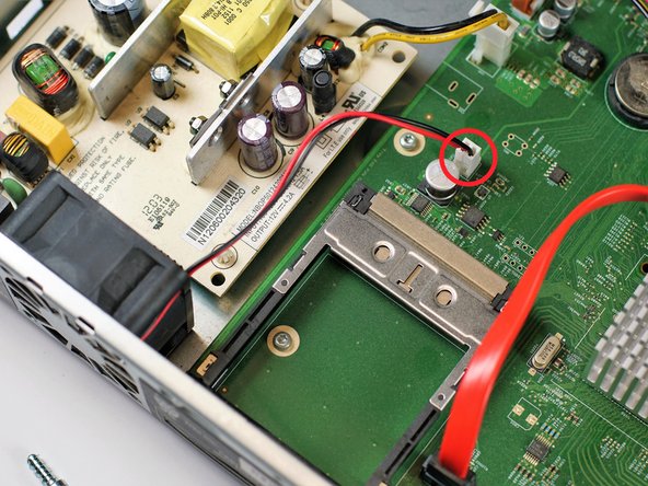

  5. TiVo Premiere XL4 Motherboard Replacement: crwdns2935265:05crwdnd2935265:01crwdnd2935265:02crwdne2935265:0 TiVo Premiere XL4 Motherboard Replacement: crwdns2935265:05crwdnd2935265:02crwdnd2935265:02crwdne2935265:0
    • Unplug the wire of the fan by gently squeezing the connector and lifting up.

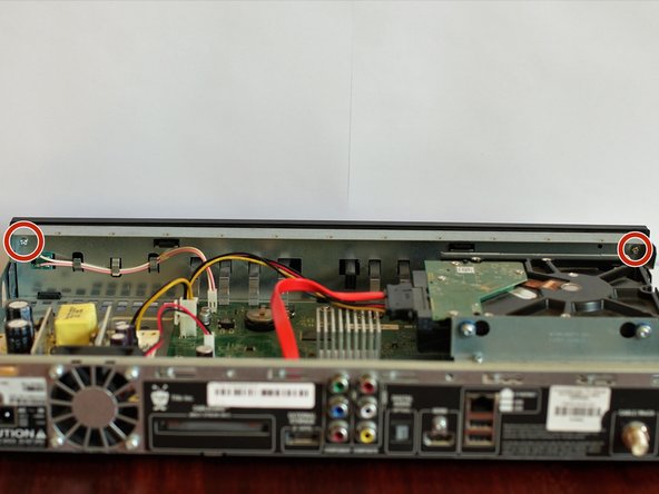

    • Remove two 100 mm T10 screws connecting the front cover to the hardware of the box using a Torx screwdriver.
    • Unplug the connector from the front panel.

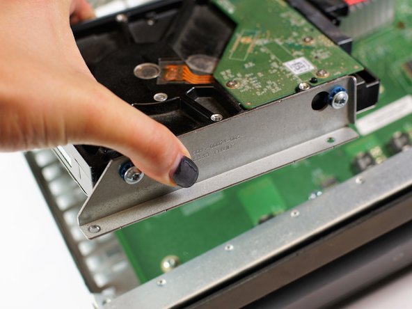

    • Remove the following (2) 80 mm T10 screws including the (2) 80 mm T10 screws located on the other side using the Torx Screwdriver.
    • Remove hard drive from on top of the motherboard.

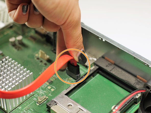

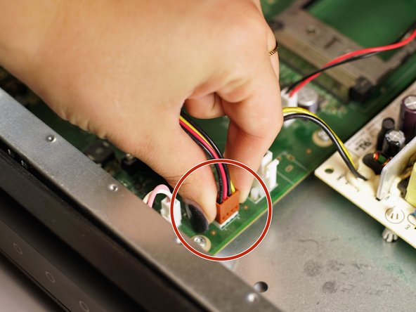

    • Pinch the connector of the bundle of wires (the bundle having black, red, black and yellow wires) and gently remove from the motherboard.
    • Pinch the connector of the single flat red wire and gently remove from motherboard.

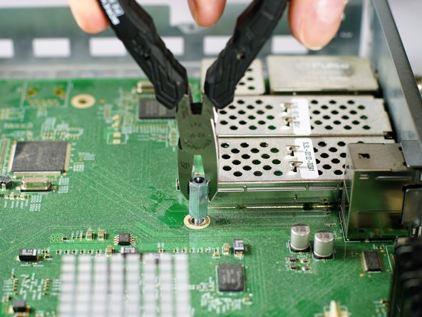

    • Remove the two 200 mm screws holding the motherboard in place to the bottom of the box using pliers.

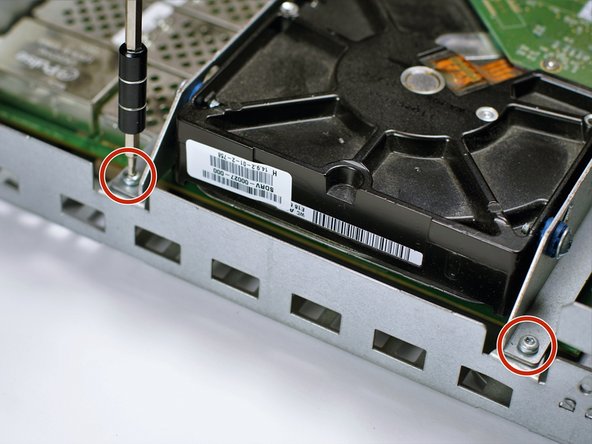

    • Remove the six 80 mm T10 screws using the Torx Screwdriver.
