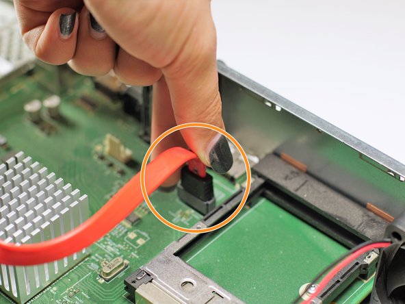

  4. TiVo Premiere XL4 Hard Drive Replacement, Hard Drive: crwdns2935265:04crwdnd2935265:01crwdnd2935265:03crwdne2935265:0 TiVo Premiere XL4 Hard Drive Replacement, Hard Drive: crwdns2935265:04crwdnd2935265:02crwdnd2935265:03crwdne2935265:0 TiVo Premiere XL4 Hard Drive Replacement, Hard Drive: crwdns2935265:04crwdnd2935265:03crwdnd2935265:03crwdne2935265:0
    • Pinch the connector of the bundle of wires (the bundle having black, red, black and yellow wires) and gently remove from the motherboard.
    • Pinch the connector of the single flat wire and gently remove from motherboard.

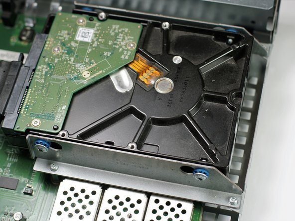

  5. TiVo Premiere XL4 Hard Drive Replacement: crwdns2935265:05crwdnd2935265:01crwdnd2935265:02crwdne2935265:0 TiVo Premiere XL4 Hard Drive Replacement: crwdns2935265:05crwdnd2935265:02crwdnd2935265:02crwdne2935265:0
    • Unscrew the following two 80 mm T10 screws connecting the hard drive to the bottom of the box using the Torx screwdriver.
    • Repeat on the other side of the hard drive.
    • There will be a total of four 80 mm T10 screws removed.
  6. TiVo Premiere XL4 Hard Drive Replacement: crwdns2935265:06crwdnd2935265:01crwdnd2935265:01crwdne2935265:0
    • Remove hard drive from box.
  7. TiVo Premiere XL4 Hard Drive Replacement: crwdns2935265:07crwdnd2935265:01crwdnd2935265:01crwdne2935265:0
    • Remove the marked (2) T10 screws and washers using a Torx Screwdriver.
    • Repeat on the opposite side for (2) T10 screws.
    • Remove the connecting cable.
    • Keep the fasteners if the hard drive needs to be replaced.
