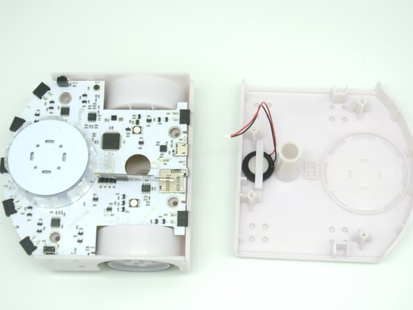

  3. Thymio II Disassembly, Opening up the Thymio II: crwdns2935265:03crwdnd2935265:01crwdnd2935265:03crwdne2935265:0 Thymio II Disassembly, Opening up the Thymio II: crwdns2935265:03crwdnd2935265:02crwdnd2935265:03crwdne2935265:0 Thymio II Disassembly, Opening up the Thymio II: crwdns2935265:03crwdnd2935265:03crwdnd2935265:03crwdne2935265:0
    • Once the screws are removed you simply need to turn the thymio around and pop the top part of the case.
    • Be careful as the speaker is still connect to the PCB so don't pull too hard.

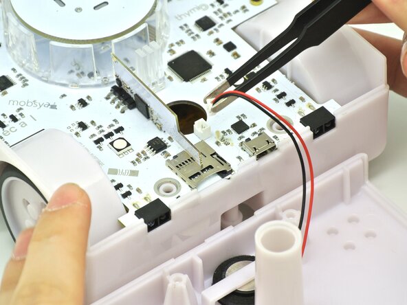

  4. Thymio II Disassembly, Disconnecting the speaker: crwdns2935265:04crwdnd2935265:01crwdnd2935265:03crwdne2935265:0 Thymio II Disassembly, Disconnecting the speaker: crwdns2935265:04crwdnd2935265:02crwdnd2935265:03crwdne2935265:0 Thymio II Disassembly, Disconnecting the speaker: crwdns2935265:04crwdnd2935265:03crwdnd2935265:03crwdne2935265:0
    • Now grab some tweezers or with your fingers disconnect the speaker cable. You should now have two seperate pieces, the top case and the bottom one.

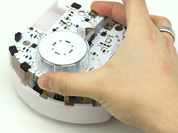

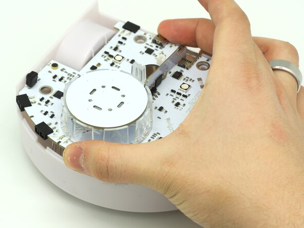

  5. Thymio II Disassembly, Removing the PCB: crwdns2935265:05crwdnd2935265:01crwdnd2935265:03crwdne2935265:0 Thymio II Disassembly, Removing the PCB: crwdns2935265:05crwdnd2935265:02crwdnd2935265:03crwdne2935265:0 Thymio II Disassembly, Removing the PCB: crwdns2935265:05crwdnd2935265:03crwdnd2935265:03crwdne2935265:0
    • To remove the PCB, take it between your hands or with one finger in the pen hole.
    • Tilt and lift the PCB.
    • Be careful as the battery and motor cables are still attached.

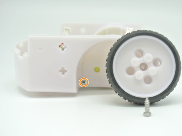

  7. Thymio II Disassembly, Removing the wheels: crwdns2935265:07crwdnd2935265:01crwdnd2935265:02crwdne2935265:0 Thymio II Disassembly, Removing the wheels: crwdns2935265:07crwdnd2935265:02crwdnd2935265:02crwdne2935265:0
    • Now that the PCB is out of the way, we can see the motors and the battery.
    • First we need to remove the main M2x8 Phillips screw that holds the wheel.
    • This will reveal the M3x20 Phillips screw that holds the motor to the chassis which needs to be removed in order to remove the motors.

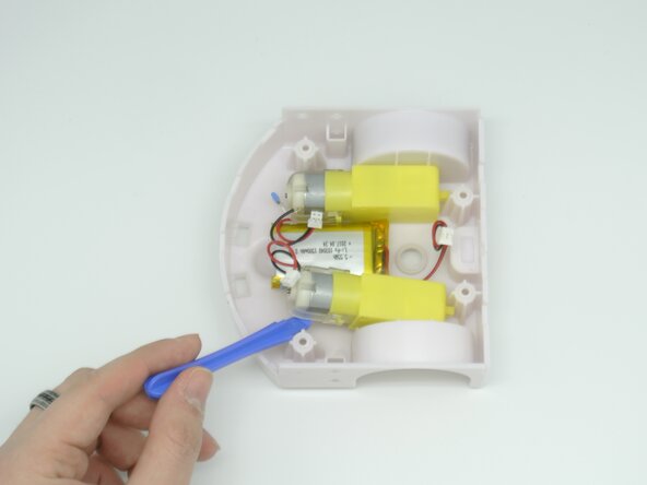

  8. Thymio II Disassembly, Removing the motors: crwdns2935265:08crwdnd2935265:01crwdnd2935265:03crwdne2935265:0 Thymio II Disassembly, Removing the motors: crwdns2935265:08crwdnd2935265:02crwdnd2935265:03crwdne2935265:0 Thymio II Disassembly, Removing the motors: crwdns2935265:08crwdnd2935265:03crwdnd2935265:03crwdne2935265:0
    • Now that the motors are free, we can simply take a prying tool and twist the motor free.
    • The motor axle is still sticking out the chassis so don't force it out if you feel some resistance.

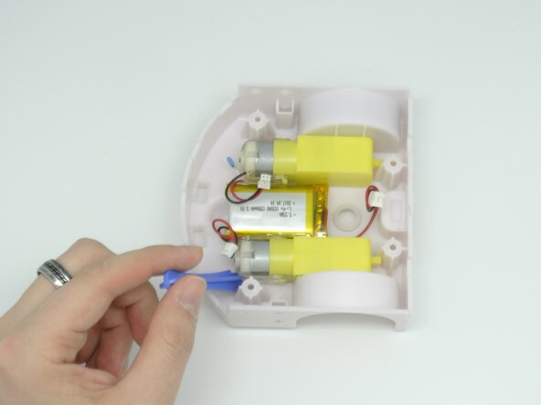

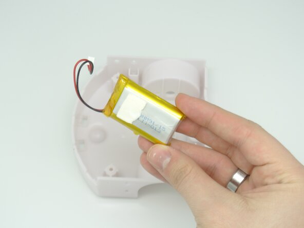

  9. Thymio II Disassembly, Removing the battery: crwdns2935265:09crwdnd2935265:01crwdnd2935265:02crwdne2935265:0 Thymio II Disassembly, Removing the battery: crwdns2935265:09crwdnd2935265:02crwdnd2935265:02crwdne2935265:0
    • The battery is glued to the chassis with an adhesive pad. To remove the battery, use a prying tool to get under the adhesive pad and remove it.
    • Only use the prying tool on the adhesive pad, not the battery itself.
