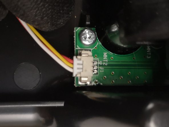

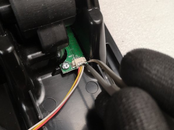

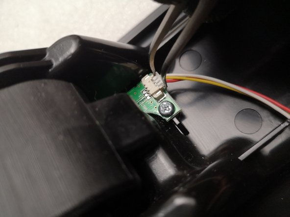

  4. Thrustmaster T3PM RJ12 main cable Replacement, Disconnect the wires from pedal sensors: crwdns2935265:04crwdnd2935265:01crwdnd2935265:03crwdne2935265:0 Thrustmaster T3PM RJ12 main cable Replacement, Disconnect the wires from pedal sensors: crwdns2935265:04crwdnd2935265:02crwdnd2935265:03crwdne2935265:0 Thrustmaster T3PM RJ12 main cable Replacement, Disconnect the wires from pedal sensors: crwdns2935265:04crwdnd2935265:03crwdnd2935265:03crwdne2935265:0
    • Use the Tweezers to carefully remove the wires from the sensors

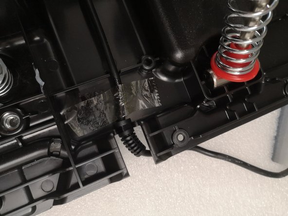

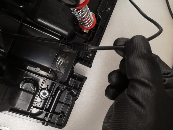

  5. Thrustmaster T3PM RJ12 main cable Replacement, Remove tape: crwdns2935265:05crwdnd2935265:01crwdnd2935265:03crwdne2935265:0 Thrustmaster T3PM RJ12 main cable Replacement, Remove tape: crwdns2935265:05crwdnd2935265:02crwdnd2935265:03crwdne2935265:0 Thrustmaster T3PM RJ12 main cable Replacement, Remove tape: crwdns2935265:05crwdnd2935265:03crwdnd2935265:03crwdne2935265:0
    • Lift the tape and remove the cable
    • You can keep the original tape, add new tape or use some other method to stabilize the cable.
  6. Thrustmaster T3PM RJ12 main cable Replacement, Replace the cable: crwdns2935265:06crwdnd2935265:01crwdnd2935265:02crwdne2935265:0 Thrustmaster T3PM RJ12 main cable Replacement, Replace the cable: crwdns2935265:06crwdnd2935265:02crwdnd2935265:02crwdne2935265:0
    • Carefully connect the wires of a new cable with the sensors
