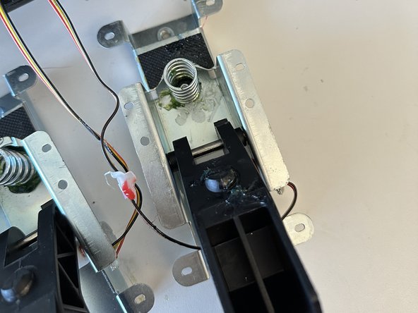

  3. Thrustmaster T3PA Pedal Spring Replacement: crwdns2935265:03crwdnd2935265:01crwdnd2935265:01crwdne2935265:0
    • Once open, remove the 6 screws holding the pedal in place with the same PH2 screwdriver. Then pull out the pedal.
    • NOTE: DO NOT UNSCREW THE MIDDLE SCREW, IT KEEPS THE SPRING IN PLACE.

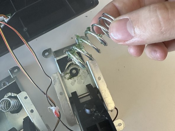

  4. Thrustmaster T3PA Pedal Spring Replacement: crwdns2935265:04crwdnd2935265:01crwdnd2935265:03crwdne2935265:0 Thrustmaster T3PA Pedal Spring Replacement: crwdns2935265:04crwdnd2935265:02crwdnd2935265:03crwdne2935265:0 Thrustmaster T3PA Pedal Spring Replacement: crwdns2935265:04crwdnd2935265:03crwdnd2935265:03crwdne2935265:0
    • Once it has been removed, pull the pedal forward and simply remove the spring.
    • NOTE: BE CAREFUL WITH THE GREASE, WASH YOUR HANDS ONCE YOU HAVE TOUCHED IT, DO NOT TOUCH YOUR EYES OR FACE WITH IT ON YOUR HANDS.
For reassembly, simply follow the steps in reverse.
