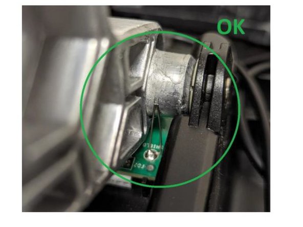

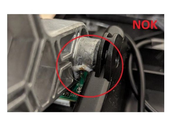

    • Using a cloth, clean the extremities of the axes of both the gas and clutch pedal.
    • Carefully clean the metal strands soldered to the PCB. These two metal strands must always remain in contact with the axis throughout the pedal’s entire movement.
