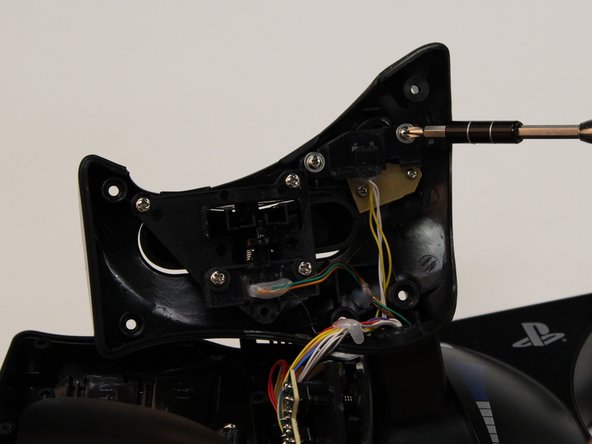

    • Using your hands, pull away the panel from the throttle.
  3. Thrustmaster T Flight Hotas 4 R2 & L2 Buttons Replacement, R2 & L2 Buttons: crwdns2935265:03crwdnd2935265:01crwdnd2935265:02crwdne2935265:0 Thrustmaster T Flight Hotas 4 R2 & L2 Buttons Replacement, R2 & L2 Buttons: crwdns2935265:03crwdnd2935265:02crwdnd2935265:02crwdne2935265:0
    • Remove the two 7 mm J1 JIS head screws from the panel covering the buttons.

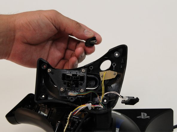

  4. Thrustmaster T Flight Hotas 4 R2 & L2 Buttons Replacement: crwdns2935265:04crwdnd2935265:01crwdnd2935265:02crwdne2935265:0 Thrustmaster T Flight Hotas 4 R2 & L2 Buttons Replacement: crwdns2935265:04crwdnd2935265:02crwdnd2935265:02crwdne2935265:0
    • Pull the panel that is covering the R2 button away from the throttle.
  5. Thrustmaster T Flight Hotas 4 R2 & L2 Buttons Replacement: crwdns2935265:05crwdnd2935265:01crwdnd2935265:02crwdne2935265:0 Thrustmaster T Flight Hotas 4 R2 & L2 Buttons Replacement: crwdns2935265:05crwdnd2935265:02crwdnd2935265:02crwdne2935265:0
    • Carefully push the R2 button from the outside of the panel.
    • Be cautious of the spring attached to the button as it can be easily lost.

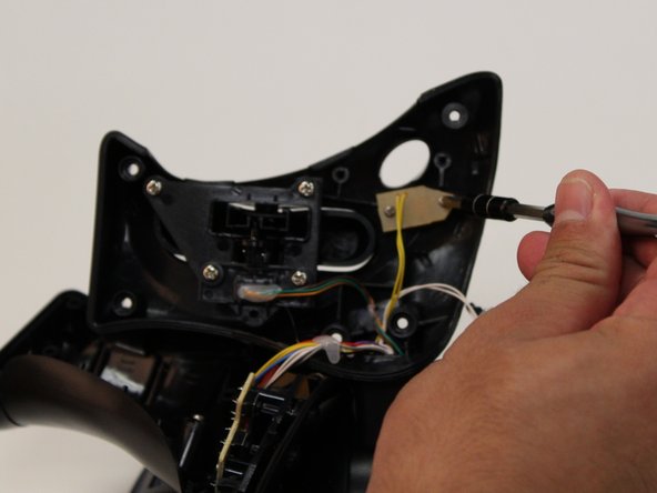

  6. Thrustmaster T Flight Hotas 4 R2 & L2 Buttons Replacement: crwdns2935265:06crwdnd2935265:01crwdnd2935265:02crwdne2935265:0 Thrustmaster T Flight Hotas 4 R2 & L2 Buttons Replacement: crwdns2935265:06crwdnd2935265:02crwdnd2935265:02crwdne2935265:0
    • Remove the two 4 mm J1 JIS head screws from the panel covering the L2 button.
  7. Thrustmaster T Flight Hotas 4 R2 & L2 Buttons Replacement: crwdns2935265:07crwdnd2935265:01crwdnd2935265:02crwdne2935265:0 Thrustmaster T Flight Hotas 4 R2 & L2 Buttons Replacement: crwdns2935265:07crwdnd2935265:02crwdnd2935265:02crwdne2935265:0
    • Carefully push the L2 button from the outside of the panel.
