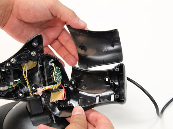

  4. Thrustmaster T Flight Hotas 4 PlayStation Action Buttons Replacement: crwdns2935265:04crwdnd2935265:01crwdnd2935265:02crwdne2935265:0 Thrustmaster T Flight Hotas 4 PlayStation Action Buttons Replacement: crwdns2935265:04crwdnd2935265:02crwdnd2935265:02crwdne2935265:0
    • Remove exterior panel from the throttle by using your hands to gently pull the panel away.

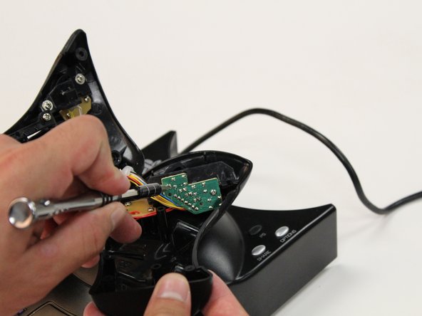

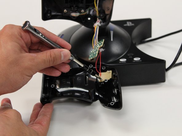

  5. Thrustmaster T Flight Hotas 4 PlayStation Action Buttons Replacement: crwdns2935265:05crwdnd2935265:01crwdnd2935265:02crwdne2935265:0 Thrustmaster T Flight Hotas 4 PlayStation Action Buttons Replacement: crwdns2935265:05crwdnd2935265:02crwdnd2935265:02crwdne2935265:0
    • Remove the two 6 mm J1 JIS head screws from the circuit board.

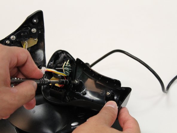

  7. Thrustmaster T Flight Hotas 4 PlayStation Action Buttons Replacement: crwdns2935265:07crwdnd2935265:01crwdnd2935265:02crwdne2935265:0 Thrustmaster T Flight Hotas 4 PlayStation Action Buttons Replacement: crwdns2935265:07crwdnd2935265:02crwdnd2935265:02crwdne2935265:0
    • Remove the 6 mm J1 JIS head screw that is attached to the black plastic cover.
  8. Thrustmaster T Flight Hotas 4 PlayStation Action Buttons Replacement: crwdns2935265:08crwdnd2935265:01crwdnd2935265:02crwdne2935265:0 Thrustmaster T Flight Hotas 4 PlayStation Action Buttons Replacement: crwdns2935265:08crwdnd2935265:02crwdnd2935265:02crwdne2935265:0
    • Remove black plastic cover.

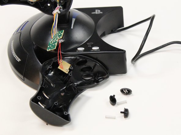

    • Once the black plastic cover is removed, push the buttons inward from the outside of the device.
    • Be aware of the springs. They are small and easy to lose.
    • This step only replaces the x, square, and circle buttons.

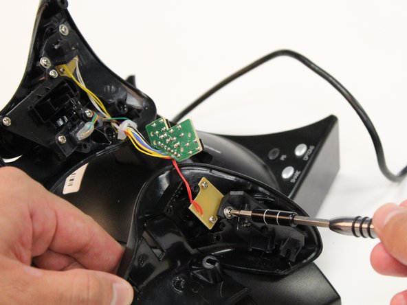

  10. Thrustmaster T Flight Hotas 4 PlayStation Action Buttons Replacement: crwdns2935265:010crwdnd2935265:01crwdnd2935265:02crwdne2935265:0 Thrustmaster T Flight Hotas 4 PlayStation Action Buttons Replacement: crwdns2935265:010crwdnd2935265:02crwdnd2935265:02crwdne2935265:0
    • Remove the two 6 mm J1 JIS head screws that are attached to the tan plastic cover.
    • Removal of the screws will detach the exterior panel from the device.

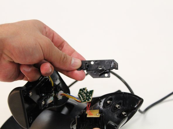

  11. Thrustmaster T Flight Hotas 4 PlayStation Action Buttons Replacement: crwdns2935265:011crwdnd2935265:01crwdnd2935265:01crwdne2935265:0
    • Carefully remove tan plastic cover.
  12. Thrustmaster T Flight Hotas 4 PlayStation Action Buttons Replacement: crwdns2935265:012crwdnd2935265:01crwdnd2935265:01crwdne2935265:0
    • Once the black panel is disconnected, push the triangle button inward from the outside of the exterior panel.
