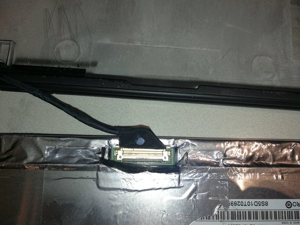

    2. ThinkVision M14 Portable Monitor Monitor panel Replacement, Removing the panel: crwdns2935265:02crwdnd2935265:01crwdnd2935265:01crwdne2935265:0
      • The panel is held in with three strips of 10mm wide ~0,5-0,8mm thick strechy adhesive tape between the back of the panel and the magnesium case. Removal is difficult. Heating the case from the back can help. If the panel is already broken it is ok to force it out with a pry tool.
      • Pay attention not to damage the display cable located in the lower left corner of the panel.
      • Wear safety goggles since the display panel is glass and will shatter if bent.
    3. ThinkVision M14 Portable Monitor Monitor panel Replacement, Removing the display cable: crwdns2935265:03crwdnd2935265:01crwdnd2935265:02crwdne2935265:0 ThinkVision M14 Portable Monitor Monitor panel Replacement, Removing the display cable: crwdns2935265:03crwdnd2935265:02crwdnd2935265:02crwdne2935265:0
      • The display cable is very delicate. Pay attention when removing it.
      • Peel off the metal tape and pull the cable out towards the lower side of the panel. Do not lift upwards on the cable.
