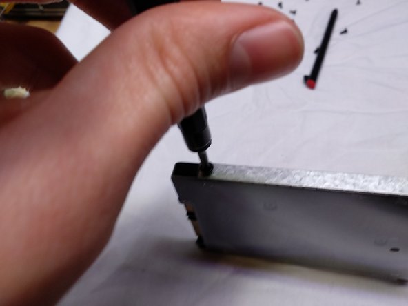

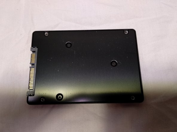

  6. ThinkPad Yoga 12 SSD Replacement, Remove enclosure: crwdns2935265:06crwdnd2935265:01crwdnd2935265:02crwdne2935265:0 ThinkPad Yoga 12 SSD Replacement, Remove enclosure: crwdns2935265:06crwdnd2935265:02crwdnd2935265:02crwdne2935265:0
    • Remove the 4 identical Phillips screws with a Phillips 00 screw driver (they are on both sides).
  7. ThinkPad Yoga 12 SSD Replacement, Done!: crwdns2935265:07crwdnd2935265:01crwdnd2935265:02crwdne2935265:0 ThinkPad Yoga 12 SSD Replacement, Done!: crwdns2935265:07crwdnd2935265:02crwdnd2935265:02crwdne2935265:0
    • Carefully remove the SSD enclosure.
    • Note: The SSD enclosure is made of thin metal. It can be easily deformed. Be careful when removing from the SSD.
