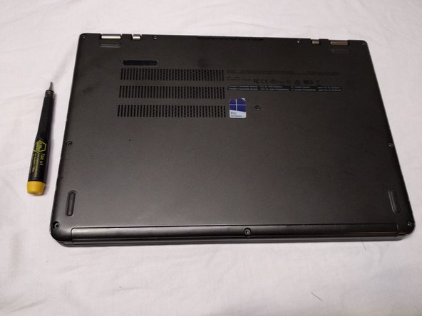

  1. ThinkPad Yoga 12 Heasink & CPU Fan Replacement, Bottom Cover Removal: crwdns2935265:01crwdnd2935265:01crwdnd2935265:03crwdne2935265:0 ThinkPad Yoga 12 Heasink & CPU Fan Replacement, Bottom Cover Removal: crwdns2935265:01crwdnd2935265:02crwdnd2935265:03crwdne2935265:0 ThinkPad Yoga 12 Heasink & CPU Fan Replacement, Bottom Cover Removal: crwdns2935265:01crwdnd2935265:03crwdnd2935265:03crwdne2935265:0
    • Remove the nine Phillips screws using a Philips 00 screwdriver

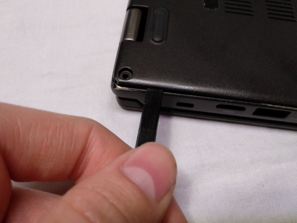

  2. ThinkPad Yoga 12 Heasink & CPU Fan Replacement, Prying: crwdns2935265:02crwdnd2935265:01crwdnd2935265:02crwdne2935265:0 ThinkPad Yoga 12 Heasink & CPU Fan Replacement, Prying: crwdns2935265:02crwdnd2935265:02crwdnd2935265:02crwdne2935265:0
    • Pry up the case carefully using a spudger.
    • Make sure to not push the spudger in too far, as this could result in internal damage

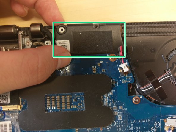

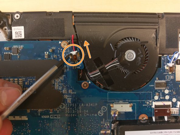

  3. ThinkPad Yoga 12 Heasink & CPU Fan Replacement, Remove Speaker: crwdns2935265:03crwdnd2935265:01crwdnd2935265:03crwdne2935265:0 ThinkPad Yoga 12 Heasink & CPU Fan Replacement, Remove Speaker: crwdns2935265:03crwdnd2935265:02crwdnd2935265:03crwdne2935265:0 ThinkPad Yoga 12 Heasink & CPU Fan Replacement, Remove Speaker: crwdns2935265:03crwdnd2935265:03crwdnd2935265:03crwdne2935265:0
    • Top speaker left which needs to be removed to reveal the cooling system
    • Push out the plug for the speaker in the direction of the arrow.
    • Grab the speaker on the top an bottom and pull it out.
