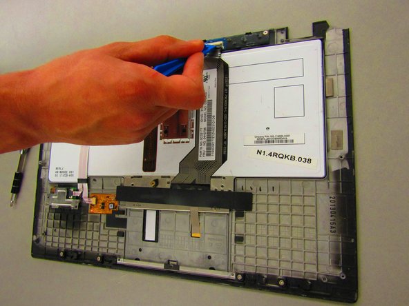

    • Use the Plastic Spudger to gently release the ribbon cable attached to the keyboard.
    • Place device to side.

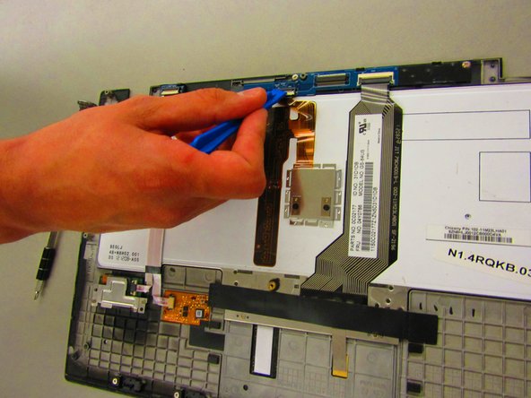

  5. ThinkPad X1 Carbon Push Button Controls Replacement: crwdns2935265:05crwdnd2935265:01crwdnd2935265:03crwdne2935265:0 ThinkPad X1 Carbon Push Button Controls Replacement: crwdns2935265:05crwdnd2935265:02crwdnd2935265:03crwdne2935265:0 ThinkPad X1 Carbon Push Button Controls Replacement: crwdns2935265:05crwdnd2935265:03crwdnd2935265:03crwdne2935265:0
    • Unlock and remove the 3 ribbon cables along the top of the keyboard tray.
