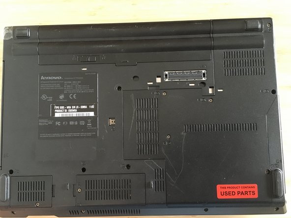

    • Turn the laptop over.
  2. ThinkPad L412 WLAN Card Replacement: crwdns2935265:02crwdnd2935265:01crwdnd2935265:01crwdne2935265:0
    • Remove the battery, and make sure the device has no power.
  3. ThinkPad L412 WLAN Card Replacement: crwdns2935265:03crwdnd2935265:01crwdnd2935265:01crwdne2935265:0

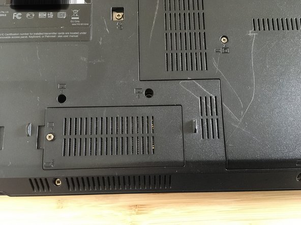

    • Then, with a J00 screwdriver, loosen the screws. Make sure the screws don't fall out!
  4. ThinkPad L412 WLAN Card Replacement: crwdns2935265:04crwdnd2935265:01crwdnd2935265:02crwdne2935265:0 ThinkPad L412 WLAN Card Replacement: crwdns2935265:04crwdnd2935265:02crwdnd2935265:02crwdne2935265:0
    • Then, use the opening tool to carefully open the lid (your fingernail can also work too).
  5. ThinkPad L412 WLAN Card Replacement: crwdns2935265:05crwdnd2935265:01crwdnd2935265:02crwdne2935265:0 ThinkPad L412 WLAN Card Replacement: crwdns2935265:05crwdnd2935265:02crwdnd2935265:02crwdne2935265:0

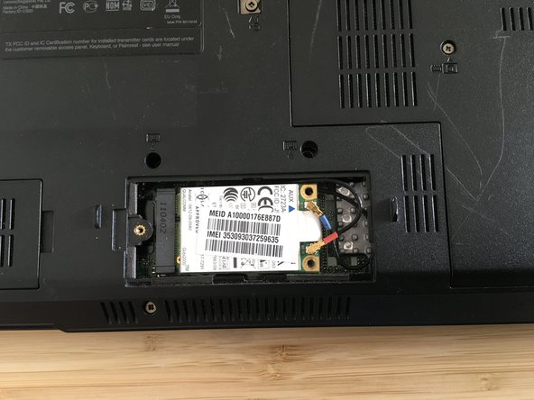

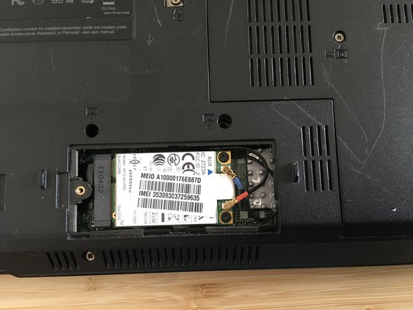

    • Next, unscrew the two screws. Then, carefully use tweezers to remove the two cables from the connectors.
  6. ThinkPad L412 WLAN Card Replacement: crwdns2935265:06crwdnd2935265:01crwdnd2935265:01crwdne2935265:0
    • Now, remove the WLAN card.
  7. ThinkPad L412 WLAN Card Replacement: crwdns2935265:07crwdnd2935265:01crwdnd2935265:03crwdne2935265:0 ThinkPad L412 WLAN Card Replacement: crwdns2935265:07crwdnd2935265:02crwdnd2935265:03crwdne2935265:0 ThinkPad L412 WLAN Card Replacement: crwdns2935265:07crwdnd2935265:03crwdnd2935265:03crwdne2935265:0
    • Next, install the new card, re-attach the cables to the connectors, and screw the two screws back into place.
  8. ThinkPad L412 WLAN Card Replacement: crwdns2935265:08crwdnd2935265:01crwdnd2935265:03crwdne2935265:0 ThinkPad L412 WLAN Card Replacement: crwdns2935265:08crwdnd2935265:02crwdnd2935265:03crwdne2935265:0 ThinkPad L412 WLAN Card Replacement: crwdns2935265:08crwdnd2935265:03crwdnd2935265:03crwdne2935265:0
