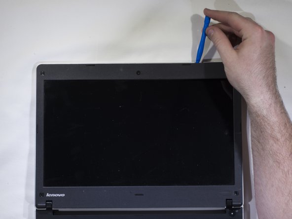

    3. ThinkPad Edge E31 Screen Replacement: crwdns2935265:05crwdnd2935265:01crwdnd2935265:02crwdne2935265:0 ThinkPad Edge E31 Screen Replacement: crwdns2935265:05crwdnd2935265:02crwdnd2935265:02crwdne2935265:0
      • There are plastic tabs every couple of inches that hold the bezel on. Wedge the plastic opening tool in the seam between the screen bezel and the edge of the laptop. This will pop the tabs and allow you to remove the bezel.
      • Continue popping the bezel tabs around the edge of the screen until all of them are free and the bezel can be removed.
